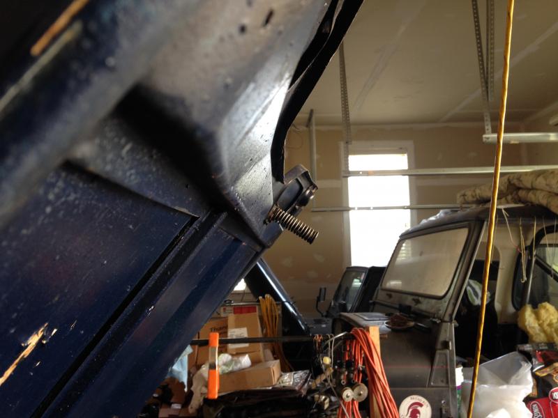

So during my restoration the shop had to buy a TR4A hood to replace my TR4 hood as it was beyond fixable. I had one of the TR4 hoods that didn't have the guide holes in the upper corners where the rubber cone shaped adjusters go. My adjusters were flat and sat on the hood. Well, I was looking at the cross brace where the latch rod with spring bolts up and it seems it is dented/creased on the driver side. Or at least I thought it was, there seems to be a diagonal dent on the passenger side as well. I think this was done to the cross brace so it conforms with the curved hood but I thought it was something the body shop overlooked. Would someone be able to look at theirs and confirm that there are indeed two diagonal dents/creases/whatever? One on driver and one on the passenger. I know...odd request... Thanks

We did that to our original hood after cracks developed on the edge of the rear brace. In the pictures above you can see the 1/2" conduit welded to the edge all the way down to the top of the curve of the hood. 1/2" conduit maybe overkill but it's what we had lying around.
