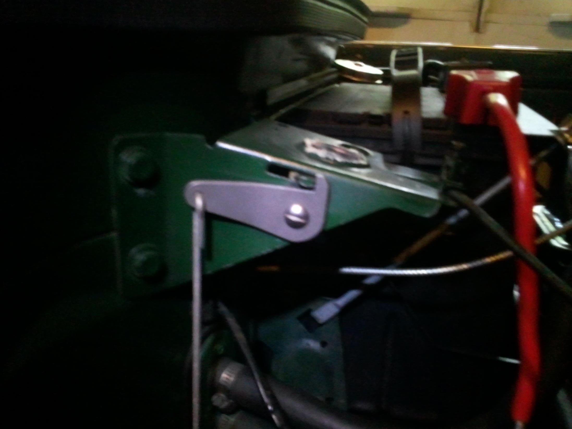

Installed. Very nice easy project. I agree it works better than the original release and it is now my primary release.
Also, as for the stop, I found some very nice nickle plated wheel collars at the model airplane shop for $2. They slip over the release rod and keep it from pulling too far. They have a tiny little hex screw that tightens them against the rod.
