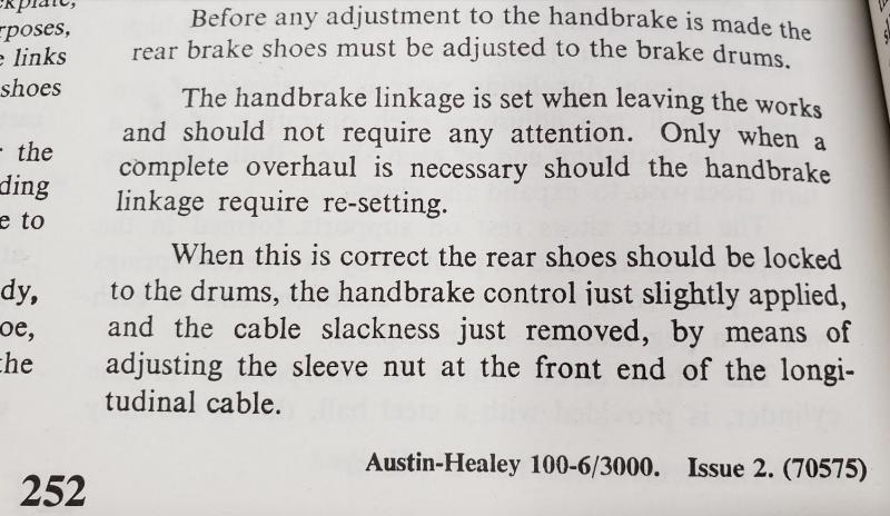

From the Bentley manual, section M.1:

Yes:
Also make certain that the slackness of the cable can be removed as they stretch over time and may need replacing.
