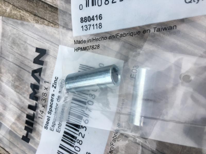

hcallaway
1 Can anyone tell me by looking at the picture if this position of the emergency cable is at the beginning of the adjustment range?
2 Since I have to cut and extend my rods should they be completely relaxed without any drag on the drum (the leaver touching the backer plate) or have the leaver with slight tension.
3 I have 1/4 steel sleeves that I will weld in place. I am not threading as I have cheap dies so I have to get this right the first time. I am thinking if I have the cable at the beginning of the range of adjustment I should be able to tighten as needed.
