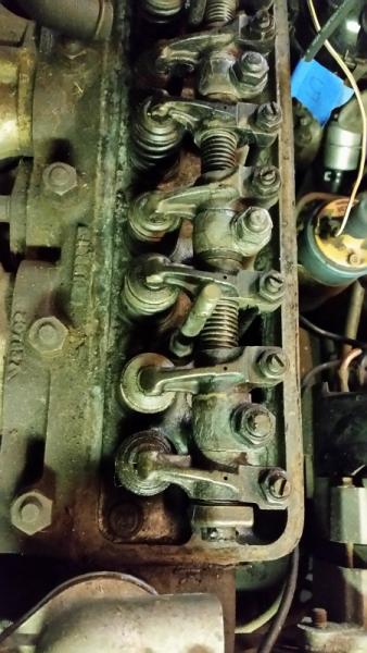

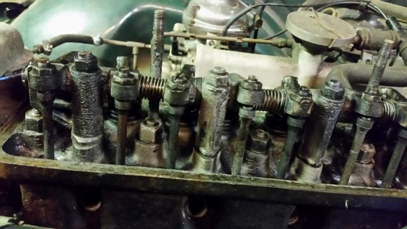

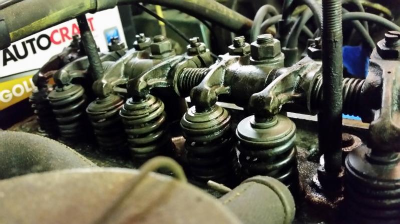

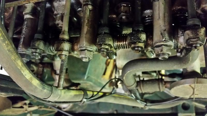

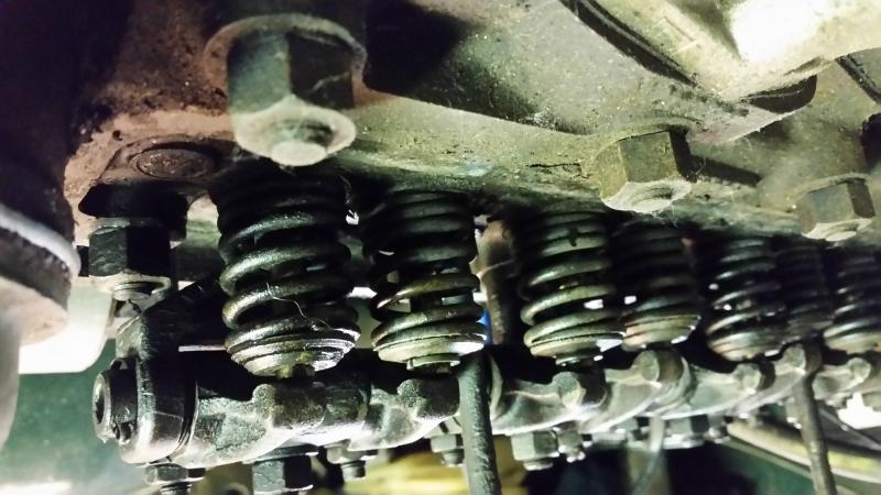

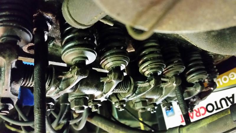

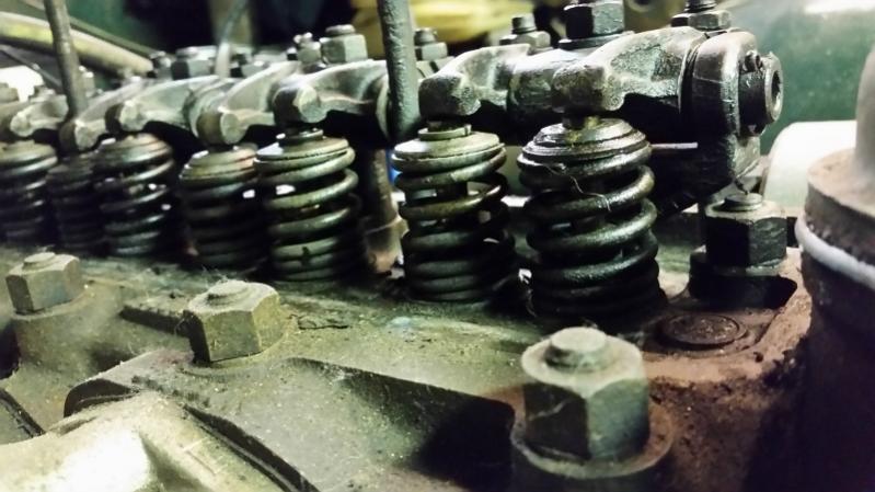

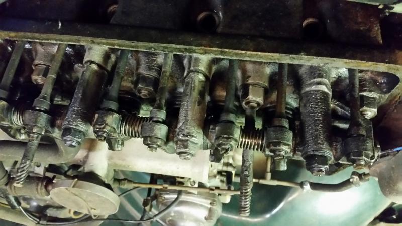

Ok, took off the valve cover and honestly I'm not sure what I'm looking for so I'm posting pictures

Pictures posted upside down but valves look questionable. Take a rubber mallet and hit each rocker
that is up to see if valve will compress. You should see valve go down and a clack noisr when the valve comes back up.
marv
glemon
It does not look rusty, but that does not mean the valves couldn't be stuck. But it is more likely the pistons, I have read that if you don't want to take the engine apart to pour some solvent like ATF or PB plaster in the cylinders and work the engine back and forth with a breaker bar or pipe on a ratchet on the crank nut, even if it does not turn at all, exert pressure back and forth. It should start to break up the corrosion holding the pistons in place and over days or weeks you get it unstuck. I think you would want to go in and clean it up eventually, but it is not unheard of to get a motor unstuck and have it run fine for some time.

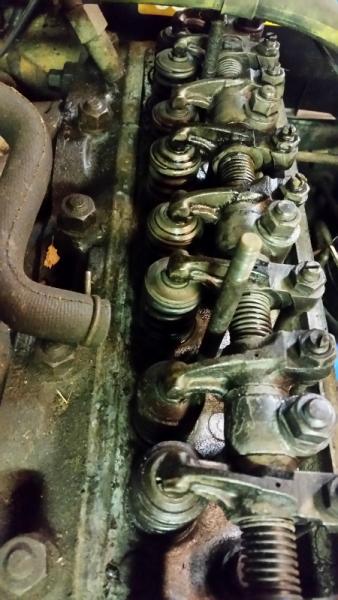

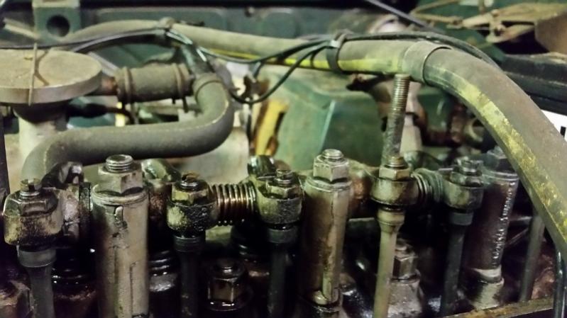

rotated the pictures and added a couple

Hey guys, I think I'm making some progress. I took rubber mallet to the rockers, had a hard time seeing the valves open, but I did hear the clack as they closed, so I think I'm ok there. I pulled the radiator and fan and put a pipe wrench on the fan hub to turn the engine. It took a breaker bar, but I got it to turn. I kept hitting the cylinders with PB blaster and turning. I can turn it now with the pipe wrench with no breaker bar. Kept hitting the cylinders with PB blaster and it is moving easier (I still don't think it would spin by hand turning the fan blades which it did a few months ago). So I'm thinking I'll just keep lubing up the cylinders and do what I'm doing till it turns more freely. What do you guys think? If going ahead as I am is good, should I be using something else to lube the cylinders?
