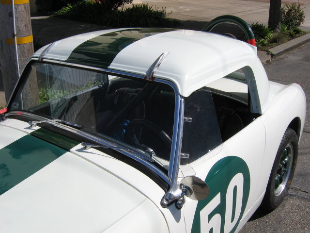

Kurt doesn't need my acknowledgement, he clearly knows the right way. This is exactly how I have done it as well. On the one that is on my race car, due to the fact is was busted/cracked in several places, and had more flex than I cared for, I went one step further by taking some foam insulation, the type used to insulate 1/2" water pipe, glued each half on the inside (lengthwise) from front to back. I then laid fiberglass cloth over the foam and finished up with some Metalglaze for a smooth finish. The exterior was epoxy premiered and painted to match the car. You can't flex the top section now if you tried, so after more than 10 years, not the slightest sign of a crack or spiderweb.

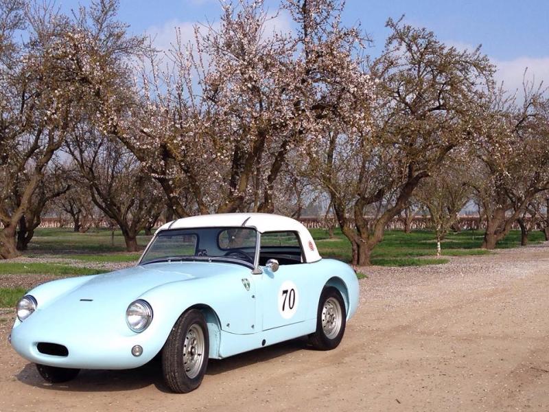

That is how I did my Hardtop in 2008. (Search hardtop in the restoration forum) . Eight years later it still looks great. A layer or two of Glass on the underside is easy to do and stiffens the top. Originally the glass was not very thick. Tap Plastics was my source for materials ( local and national) . Interlux Brightside boat paint and primer are a perfect match for the original white and is made for fiberglass boats. I also rolled it on. Lots of wetsanding, but excellent results.
