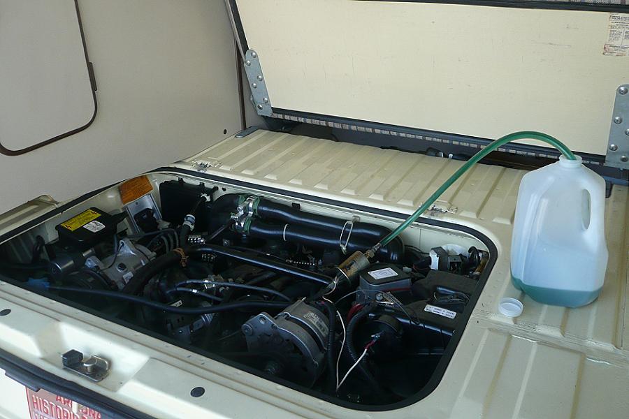

I always carry a simple in-line electric fuel pump already plumbed to easily bypass the mechanical pump and connect to power. This is my get-me-home spare so I do not have to change the mechanical pump along the side of the road (at night, in the rain, wife sitting in the car, etc).
Unfortunately my bag of small TR3/4 spares went missing when I parked the car in a public place and (because the boot was in use with something bulky) I had to leave the bag on the seat. Oh well, everything in there could be easily replaced.
That lot included the electric fuel pump so I was pleasantly surprised to find this one on eBay:
https://www.ebay.com/itm/362170401702
A suitable (made in USA) pump for 11 bucks (including shipping) is quite a good deal.
To be ready for use I changed the outlet barbed fitting to ÂĽ", added 2' of ÂĽ" fuel line and a couple of alligator clips to the power & ground leads.
In case is is not obvious, the 5/16" barb connects to the rubber line to the mechanical pump and the 2' hose to the ÂĽ" hard line to the carbs.
I thought I'd pass it along as it is pretty cheap 'insurance' against a fuel pump failure.

I bought one also, any guess on the amount of PSI the pump puts out. I have an old pressure regulator I can always use, but just curious because the reason I have the regulator is a bought an electric pump years ago and it pump gas right out the over flows on the bowls. But I bet from looking at that little guy it is maybe 3psi

I can't lay my hands on the spec at the moment, but 3 psi sounds right. Pumps are much more commonly higher pressure, 7 psi is standard for most American carbs (Holley, Carter, etc); and of course racing and fuel injection applications use even more pressure.
I keep a spare pump in the spare tire, along with a generous length of hose. In a pinch, it can also serve as a transfer pump, to loan some gas to a fellow traveler, or empty the tank into another car before doing some service.
