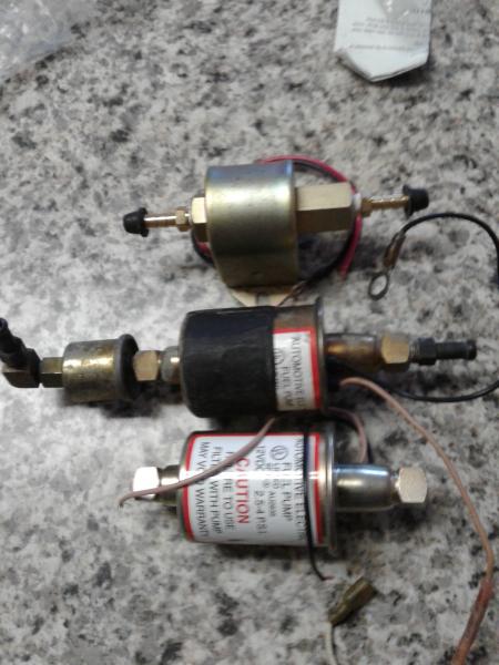

As promised earlier here are the pumps I was referring to. The top one is the one I carry in my TR3. Did a lot of research for that one. It is a EMPI 41-2500-8, 1.5 to 4 OPSI. Used a lot in old VWs. I think in the $20 range. Good pump and heavy. The second is the one I had permanently mounted in the TR250 but is now the back up pump. As you can see it is the same as the new one I recently purchased on ebay for my TR6. The only difference is it has a added fuel filter. So it does have the tick sound to the pump if you want that. Most of us have a filter at he carbs so the inline attached filter is not needed.
What's interesting is my TR6 has a square electric pump mounted below the tank on the frame as the main pump. Kinda wonder if the cam lob is worn. The last time it was driven was in 1982 into a body shop to get a paint job and the owner never cam back. Just brought it into the working garage from the pole barn and started the tear down this past sunday. I'll post pics on another post.

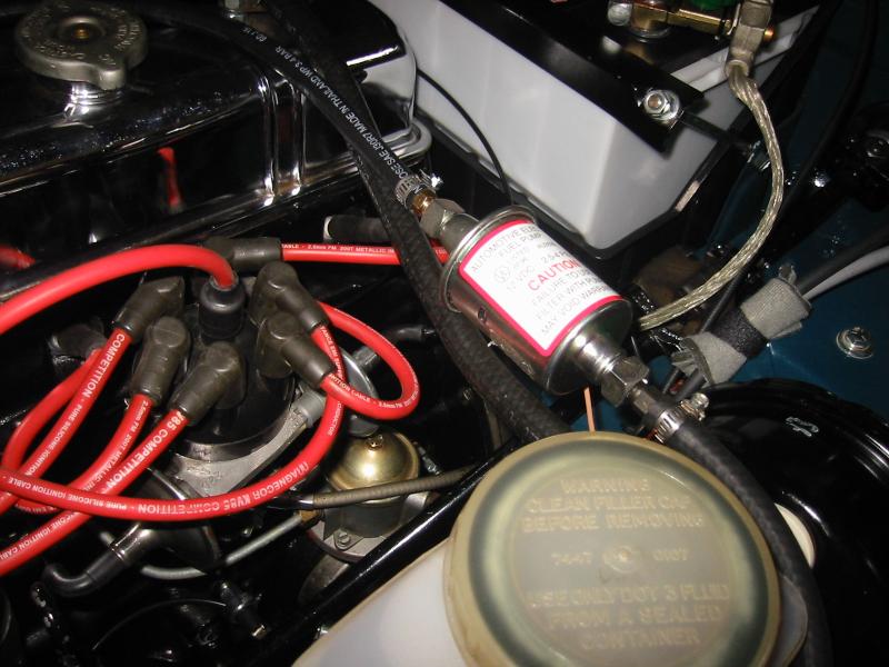

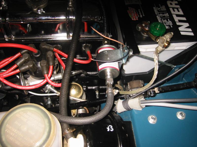

I have a question on mounting the fuel pump
1) If I'm along side the road and have to do an emergency install, would either of the pictured mounting positions work with the recommended pump? Or is there a better place to mount it? If I mounted it on the vacuum hose to the brake booster, I'm guessing cable ties would hold it to the hose. However, I'm concerned that may not be a stable location. I don't want it to fall down and bang up the inner fender nor get close to the coil or spark plugs. The other method pictured is to use an extra nut to hold the provided bracket to the battery hold down bolt. Thanks!

Mounting high has several issues. First, it has to suck fuel, which pumps do not do as well as they push fuel. That increases the chance of vapor lock. That is also why traditional pump locations are low, on the frame or in the fuel tank. Which brings up item 2...with that much rubber hose high in the engine compartment you increase the chance of a leak developing. Rubber hose should be minimized in any fuel system, as all rubber degrades. Which brings up 3, if you got a leak with a pump that high, you almost insure ignition in the engine bay, being right adjacent to the dizzy, battery, and it looks like the regulator?!.
For pump mounting you want low, rear near the tank, and minimum hose runs.

On the car I am most likely to be driving 1000s of miles from home I fashioned a bracket that I use with the big P-clip clamp:
Elaborate but all the work is done ahead, installation takes only a minute.
Bob, I like the second set-up where you are using a clamp.
Thanks Geo! I will plan to use the clamp if I ever get stranded on the road. I'm setting my wiring up to have a slip connector that will plug to the + side of the coil as suggested earlier on this thread. That was a good suggestion!
