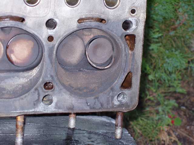

In May 2000, the valve gaps were getting tight every 500 miles. So it was time to have inserts put into the head. My 1958 TR3A had been driven 43,000 miles since I re-built the engine in 1990 with the original head and most of the original valves using lead-free gasoline during this 10-year period. The guides were the original ones too.
So in May 2000, I took the head to an engine shop and had him put in his own new valve seats for the 4 exhaust valves plus 8 new guides and 8 new valve guides that I suppplied to him.
Since then, I have driven another 64,340 miles without having to re-gap any of the valves more than a thou (0.001").
The only problem I have heard about new valve seats is when a shop does not intall the seats prperly. This happened to a friend with a TR3A where one of the inserts dropped out of place in the head and "collared" the valve as shown. He was lucky, because this happened while backing his car out the garage - not at 80 MPH on the highway.
