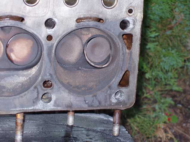

Make sure that you pick an expert. I had 4 steel inserts put in for the exhaust valves in the cast iron head of my TR3A about 7 years ago. I friend had his done by someone else and he had an insert drop.
