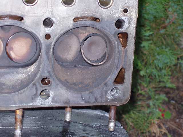

Valve seats, not valves. If they have been replaced, you will probably be able to see the transition between the new seat and the original cast iron head.
In this photo (which has a lot of deposits hiding what we are looking for), the transition can be seen as a line just outside of the dark circle where the seat is severely recessed. (Yes, I had severe valve seat recession <span style="text-decoration: underline">after</span> installing new valves and hardened seats.)

Between 1990 and 1994 (with a rebuilt engine wirh the original valves and the cast iron head as the valve seats), I had severe valve seat recession in the next 43,000 miles. So I had the insert seats put into the head for un-leaded gas. I also put in 8 new valves and 8 new valve guides and had these honed to the right tolerance.
Since then, I have had no issues with the valves or the seats in another 70,000 miles or so. In fact I hardly find any adjustment is needed for the valve gaps since.
But find a good engine shop to do this to avoid what happened to the TR3A of a friend where a fairly new valve seat fell down because it wasn't pressed in sufficiently.

And as Don's photo so graphically shows, replacing the seats carries a certain amount of risk, too.
