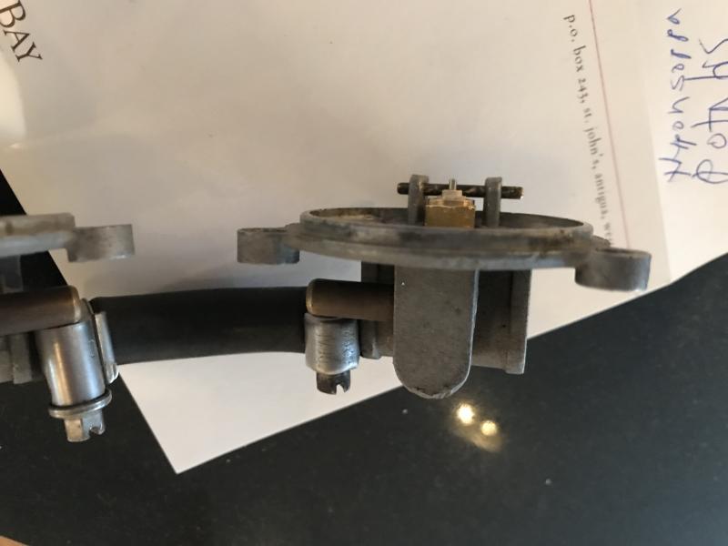

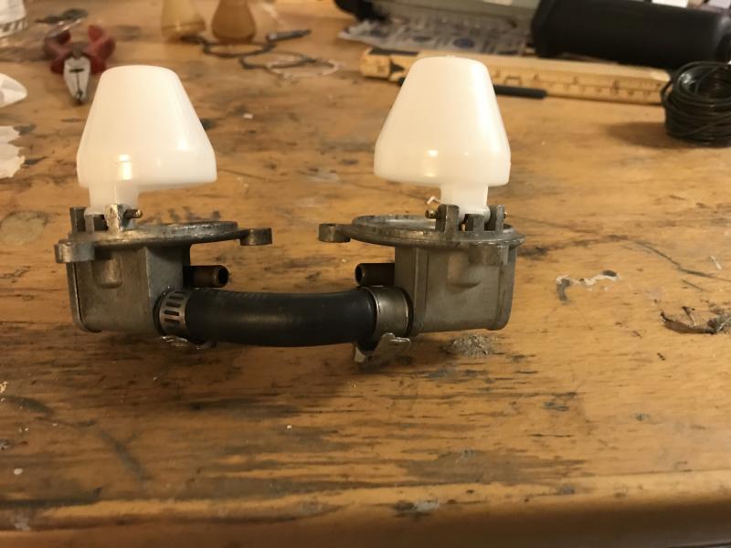

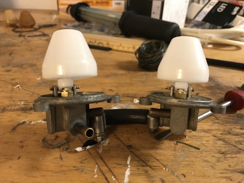

Hi! Earlier this year I had a problem with gas seeping out of one of the overflow pipes on the float lid of my BT7 Tricarb. I replaced the needle valves, which were a bit worn and the problem disappeared. I did however experience some rough running so I went ahead and adjusted the floats. It proved difficult to get a correct distance between the lid and the float and when I finally managed the angle of the metal bracket did not seem right, and the needle on one carb occasionally got stuck because of this. I ordered the newer all plastic floats hoping that they would fix the issue, but when I installed them I noticed that they would not allow the needle valves to open. In fact they kept the spring loaded plunger on the needle partly depressed even when they were in their lowest position (see pics). I am beginning to suspect that I installed the incorrect needle valves and that they are too long, which would explain all the issues. Has anyone experienced this problem and does anyone have the correct dimensions (length) of the float needle for the HS4?

As seen on this pic the valve actually sits above (or below when in the car) the float axle/pin, and that does not seem correct to me.

If you chose the all plastic floats, the valve is adjusted by increasing or decreasing the number of fiber washers between the valve body and the bowl lid.

Thank you - I have seen the posts on adjusting the needle valves with washers when using the fully plastic floats. My problem is that there are no washers and the needle valve still sits too high, so adding washers would just make the problem worse. The needle is fully closed and the float cannot move. I also have the plastic floats with the metal hinge, but I need to bend it to an awkward angle to adjust the float because the valve sits so high.
I'm not an expert with plastic floats in fact I have never used them. And I don't dispute Doug L's approach to getting an accurate float adjustment but, It sounds to me that you have a misalignment issue and not so much a height issue. Even though float levels may have optimum settings they also have a fairly wide range of operation. If you engine was running alittle rough after your initial install I believe it was because the needle valve wasn't closing tightly enough and it was leaking past and flooding or over fueling the engine. If it was starving the engine from not enough fuel then the engine would have poor acceleration and even bucking.
If the float is set too high on initial setting then the bouancy of the float rising to the top of the camber is not enough to put enough pressure on the needle valve to keep it closed. Reset your float to specification and ensure that there is no binding what so ever in its travel. A safe bet would be even set the float a smidgen lower that specification and ensure that in its rise that it can close the needle valve. If the float is too low then the car will drive with poor acceleration or even bucking. In that case, raise the float a smidgen. After you get it back together and the car is running pretty well then take it for a run, push in the clutch, shut off the engine, pull to the side of the road and pull your spark plugs to read them and see that they are burning with a good mixture. Sorry that my typing time and I didn't see you last post.

Thank you British_Recovery for providing Joe Curto's name. He has a number of tutorials on YouTube, one of which deals with SU float lids. There are apparently two versions of the HS4 lid, one older (that I apparently have) where the needle valve sits a bit higher (when turned upside down) than on the newer ones. The metal hinges on the float also look a bit different. On the older type it is flat whereas it has a "Z" shape bend on the newer ones. the all nylon floats only fits the newer lids. I will either have to try to rebend the hinges on my old floats to make them work better or modify the new all plastic ones by filing down the plastic a couple of millimeters. Will keep you posted.
After some further trial and error I think I have found out what is going on. A PO had replaced one of the floats with the newer type with the "Z" shape bend. This does not work with the older type HS4 Lid, it is not possible to get the geometry right no matter how you adjust the steel hinge, so it was prone to leaking and the float level was not right. I have decided to bite the bullet and have ordered new float lid assemblys (with floats and needles) from SU. I could have kept the two with the correct type floats, but I want to avoid having a mix of new and old, that would inevitably cause problems next time something needs to be done to the carbs.
