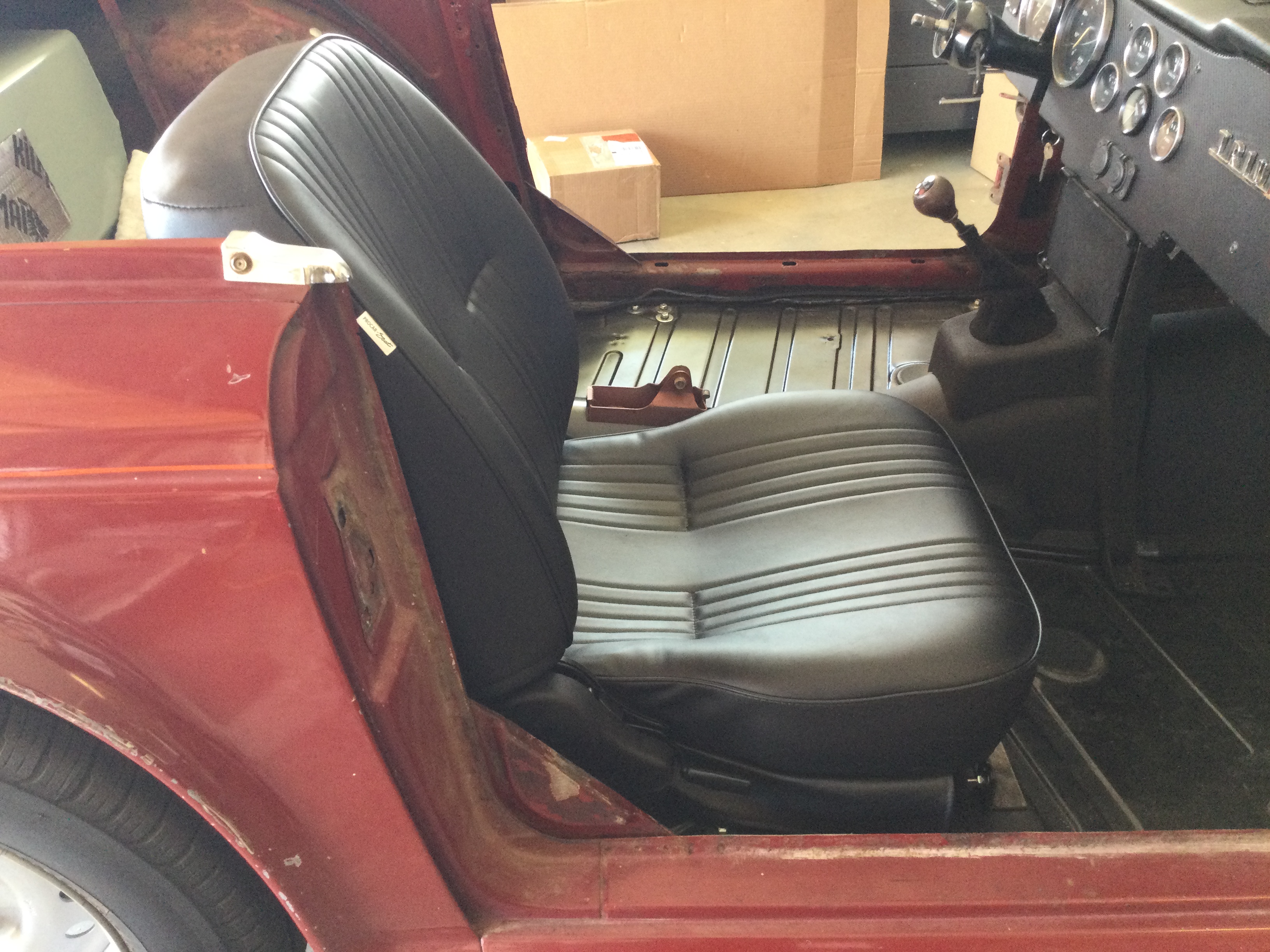

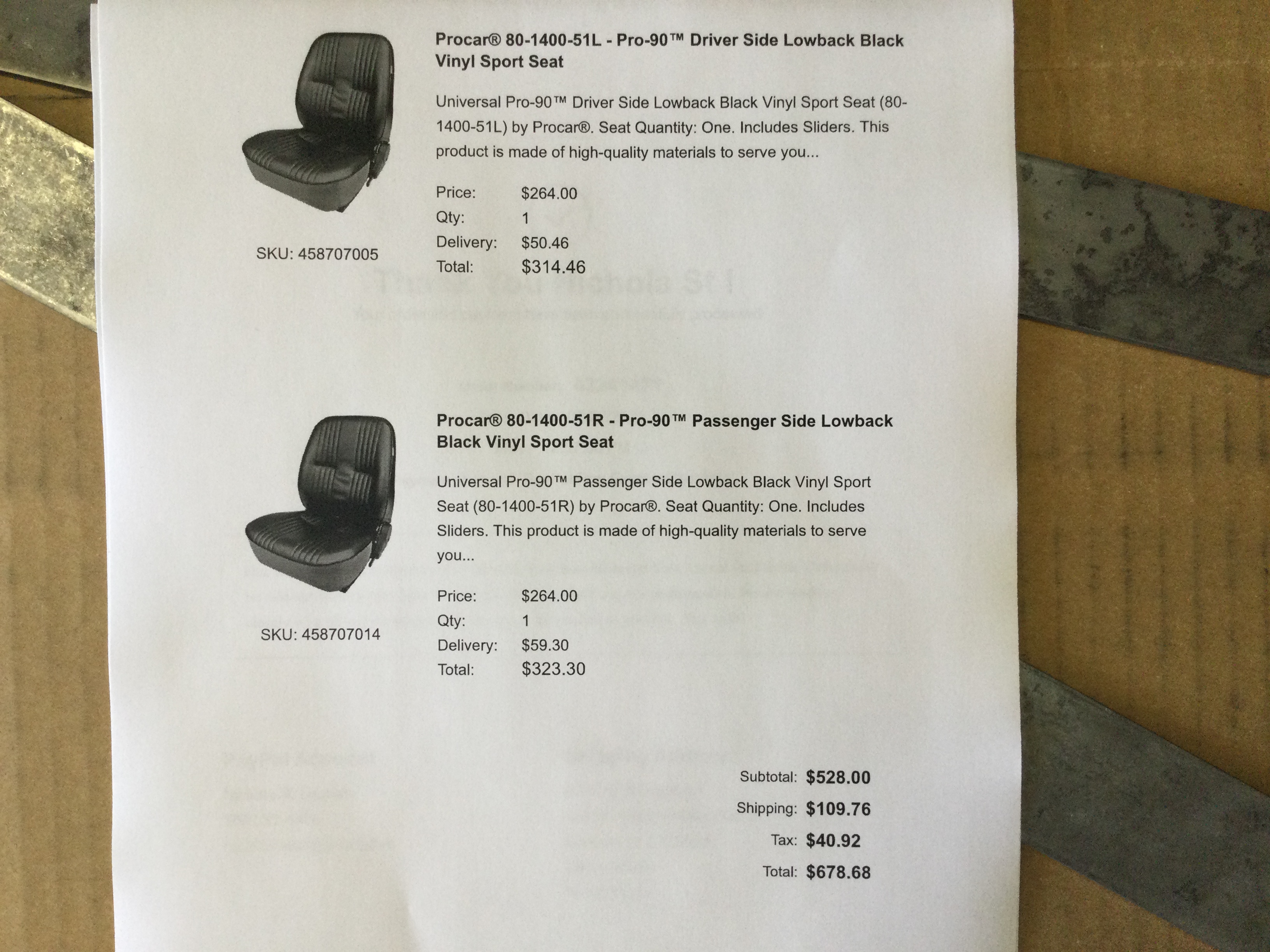

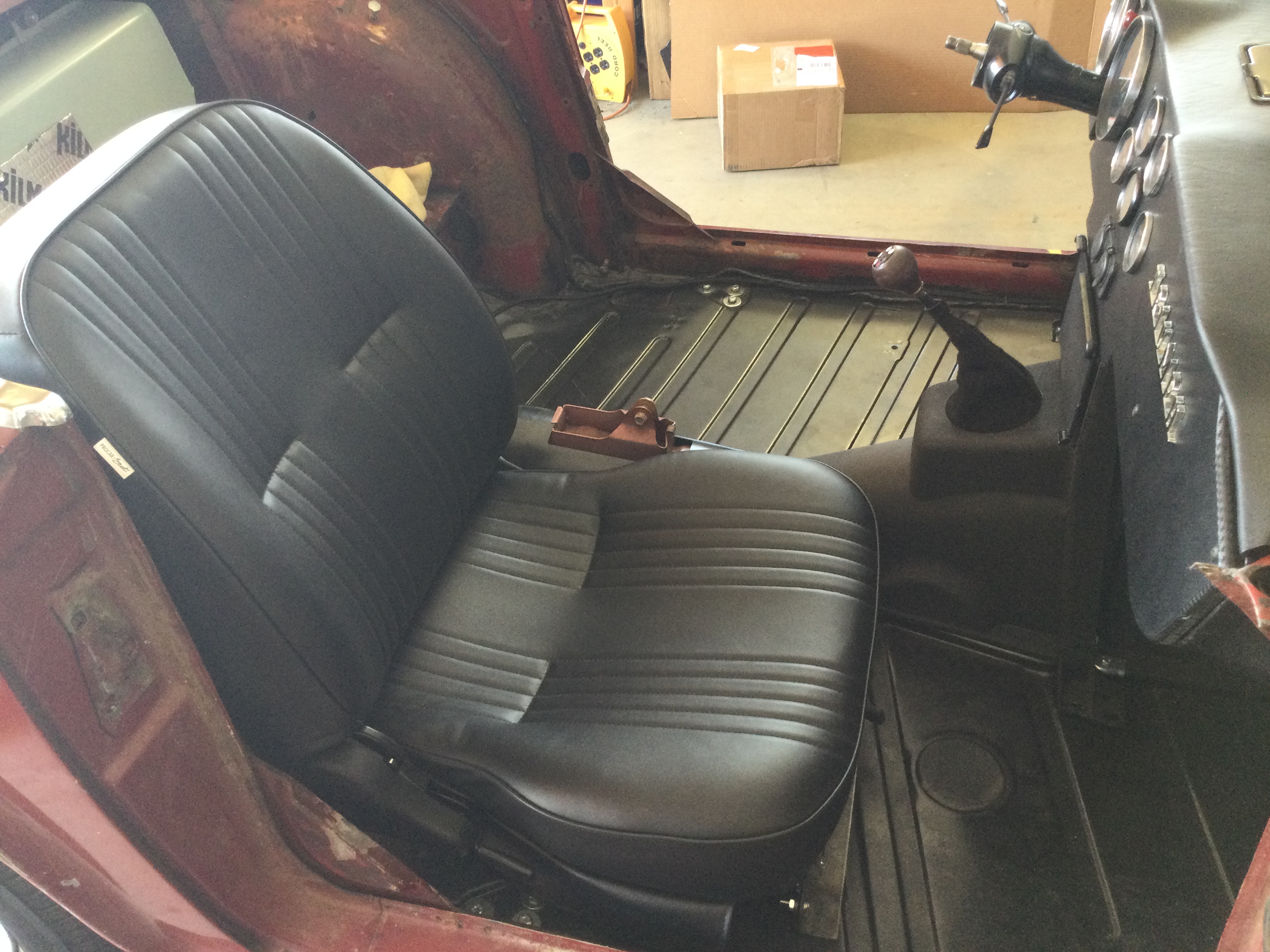

This is the fit of the Procar 80-1400-51 Pro-90, in case anyone was curious. Along with pricing including shipping to San Diego area. See pics below.

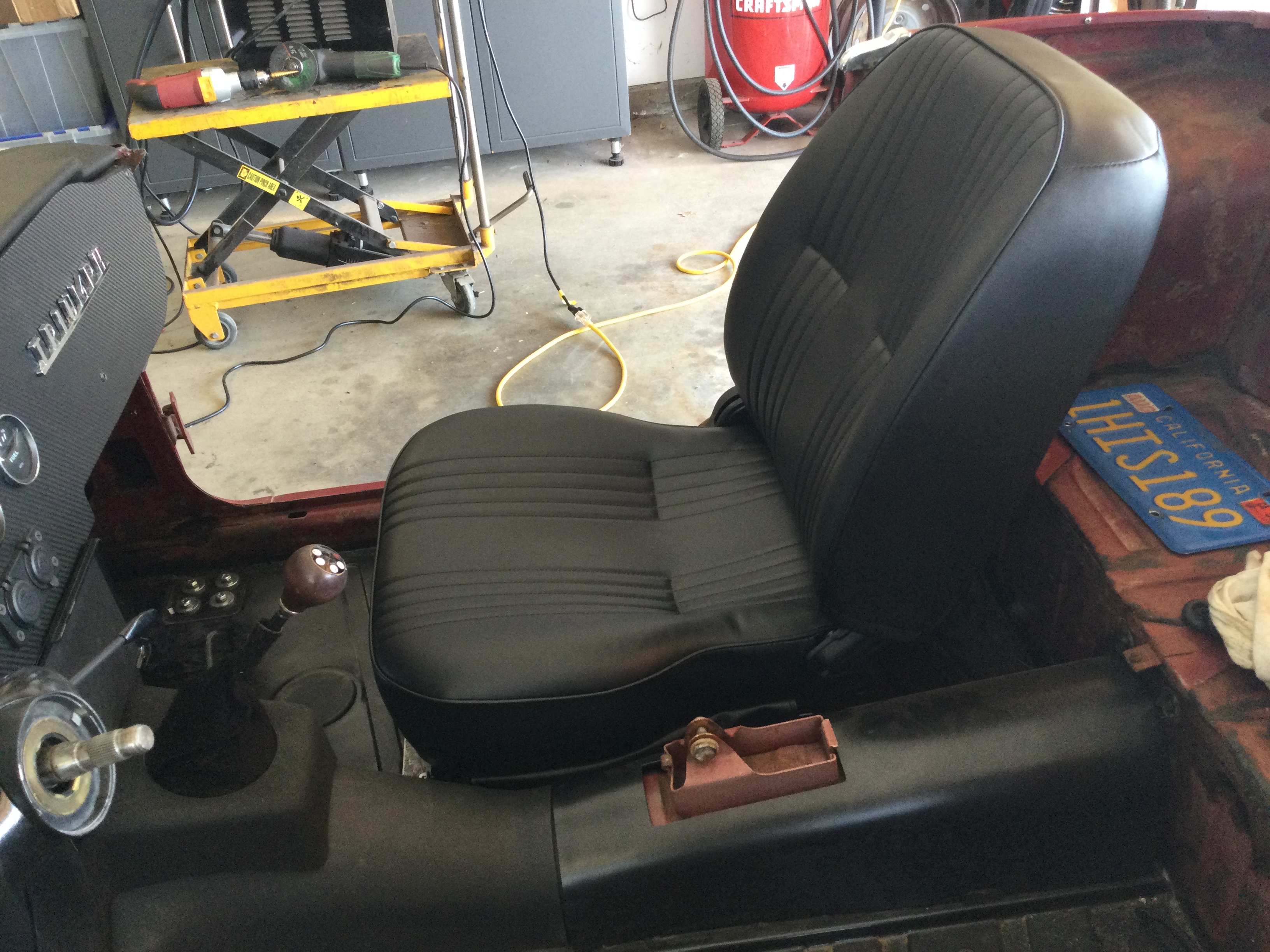

This is a follow-up on these seats after driving the car for six weeks. I am 6' 0" 185 lbs. and these seats fit in the car well but the foam is too thick for my size. I have removed the cover from the seat-back (very easy to do) four times carving more and more foam from the mid-back area and it's getting to where it's more comfortable. As you can see from the photos these seats have much more foam than the original seats. If I could figure a way to mount it on the floor without the sliders, I think that would be much better for seat height but I'm still scratching my head about how I would do that.
I'd say if the driver is 5' 9" or shorter these seats would be great without any modification. But for me the seat as it is delivered puts me too close to the steering wheel (knees and arms bent too much)... so that I can't rotate the steering wheel past my leg on a 90 degree right turn without regripping the steering wheel. I'll keep modifying until they feel just right, but just wanted to issue a buyer beware review for others needing an alternative to original seats.
On the passenger side they're marvelous, no issues at all.

You will love them and the price is right! The only issue I had was that at 6' I am a too tall for these without removing foam from the seatback. I'm satisfied for now but may continue to carve a little more from the back and seat when I feel like pulling the driver seat out. You can look at a couple more pics and a description in my website here... > TR6 Interior and Dashboard installation > The Barn <
I should also note that I have the seats mounted as low as possible while still retaining the slider functionality.

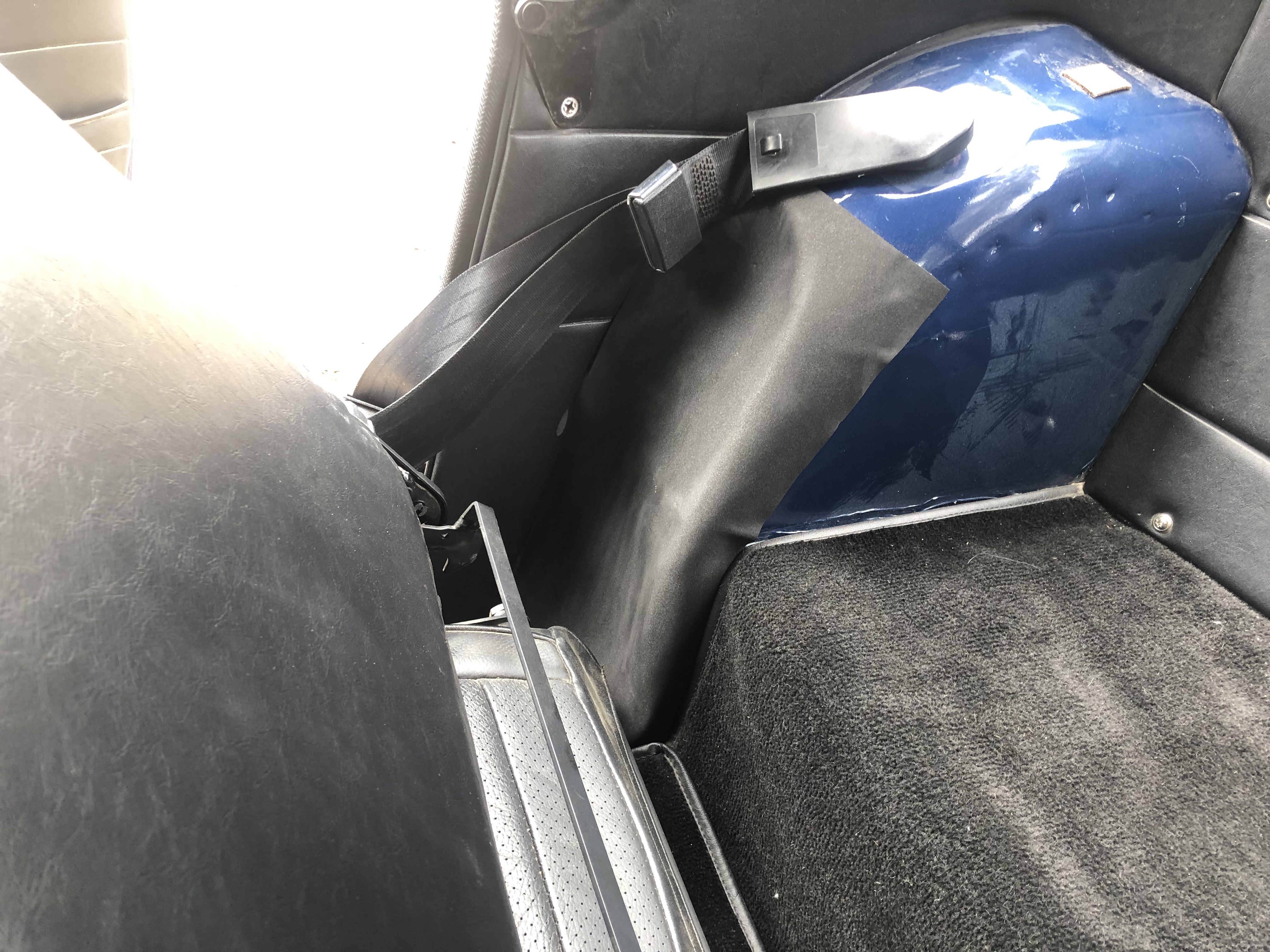

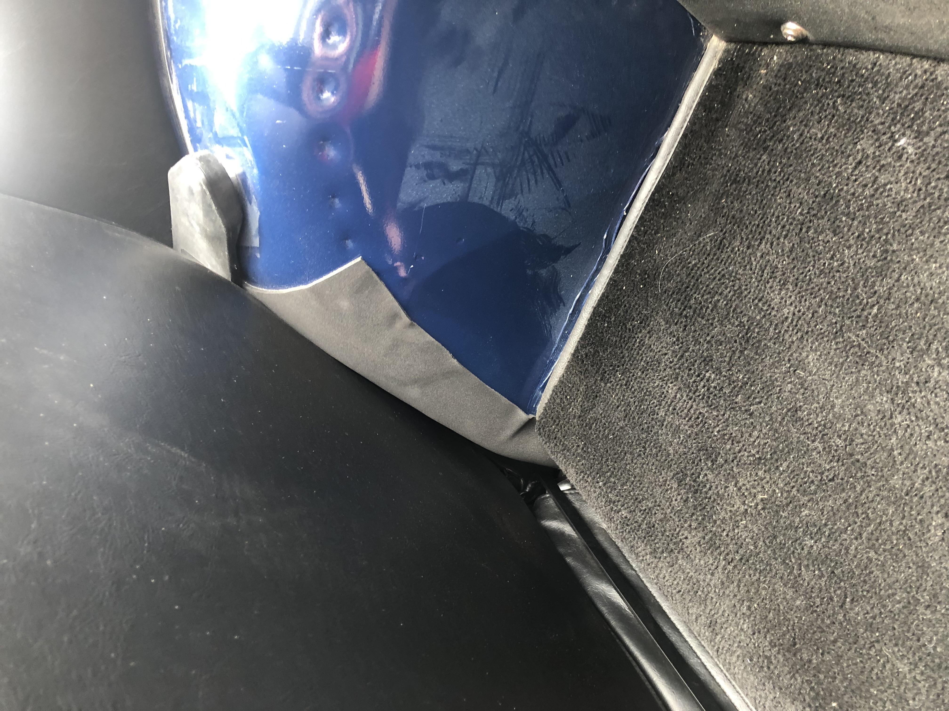

Since my last post I have had an expert make a provision in the drivers side, rear inside wheel arch, in order to accomodate the seat back. Now the seat can be moved back enough to accomodate a seven foot driver. Covered with a new vinyl arch trim its unoticable and works just fine. Should have done this before I started trying everything else.

I would love to see a photo of that modification... I thought about it but decided against it.
Lotuswins
simmo, I would really like to see that wheel arch mod, and any dimensions? Maybe just a pic of inside the wheel well? I am currently replacing my driver side floor so its perfect timing.
Thanks, Jerry
Simmo
Thanks, Jerry
Will do. At the moment the car is over in Bathurst and will have to wait till next week, after race week, to pick it up but will send you a pic or two

Hi Jerry, I drove the TR6 about 100KM yesterday in relative comfort. Legs streached out and knee not hitting the dash support yoke. I have included a couple of pics, which arent that fantastic, of the inside rear wheel arch. Sorry thats the best I can do but happy to give you any more help you may request. Regards Ian

Thank you Simmo, that is exactly what I needed. Did your expert weld in a patch or hammer it to its configuration?
thanks again, Jerry
Simmo
thanks again, Jerry
I didnt see him do it and think im pleased i didnt see it but I believe he did it with a damm big hammer but made a fairly tidy job of it. Good luck.
