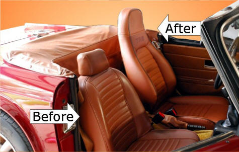

The Miata seat will definitely change the look of your car, but you may be OK with that. Posted is a comparison shot of the Miata vs. stock seat. The Miata seat appears to have deeper side bolsters, some have speakers in the headrest.

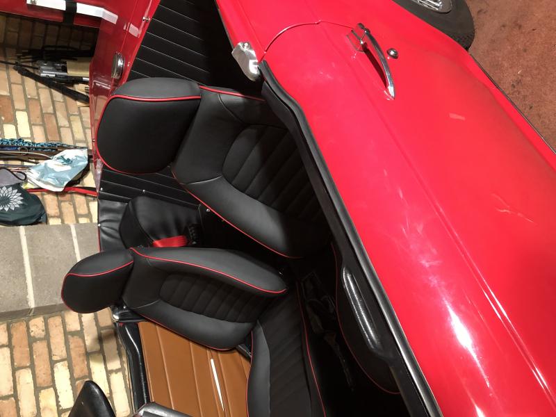

I swapped my TR seats for a a Block 1 Miata seats (early 90s) Definitely an improvement in comfort and safety. I never liked the low headrest on a tall framed person thing. (I am 6'2") We made a custom set of mounting rails, fairly easy with some welding skills. I found a good quality leather seat cover on Ebay with the embroidery. The key on the seats is to have a narrow top to work with the convertible mounting. 1975 (2020-06-17T17_57_57.757).jpg

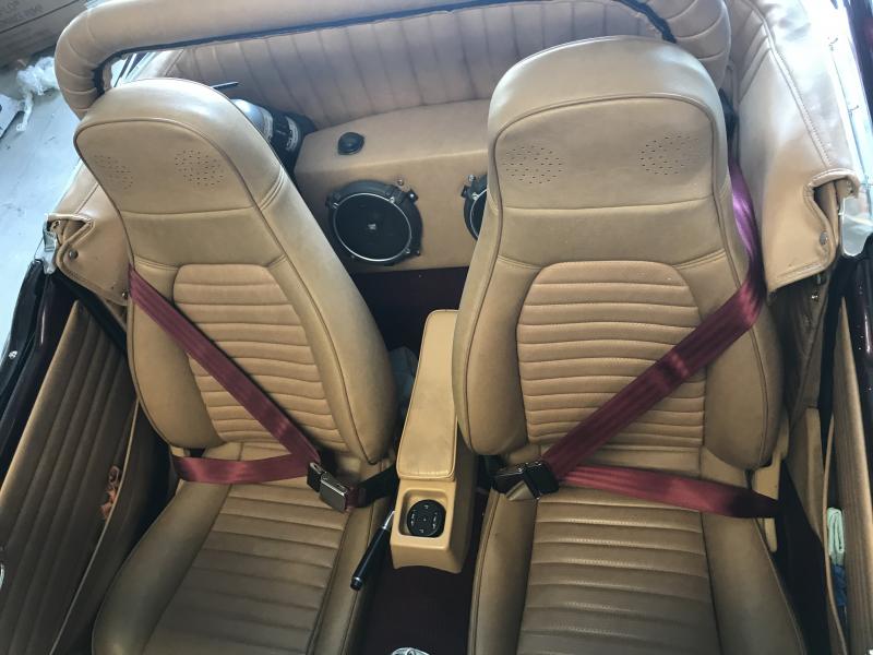

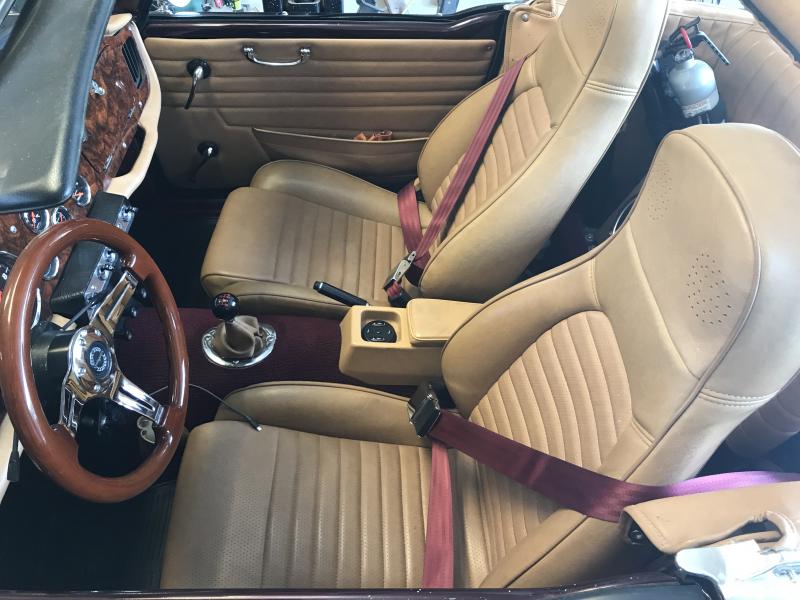

I've got Miata Seats in my TR4. I like the fit/feel much better than the original seats. I would recommend skipping the headrest speakers. Even with upgraded speakers, not much volume, or sound quality. If you don't use the headrest speakers you can better pack the area with foam or batting to get a much nicer fit of the seat covers.
I used Mr Mikes kit, great quality, good instructions. IMG_4344.jpgIMG_4345.jpg
