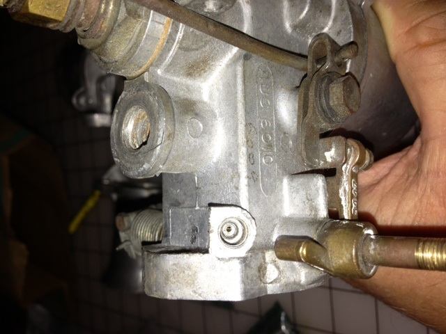

I have two sets of H1 SU carbs and neither set has the small vacuum advance pipe fitting to connect the copper pipe from the vacuum advance. Anyone have any advice where I can get one or what I can use in its place?

The fitting would have been on the hard line. I have a Morris Minor here at the moment that is set up that way. I'm not sure what the thread is (probably BSP), but you might see if you can find a close size in a good plumbing shop. You can probably get a BSP die and recut the threads or just make yourself a fitting from hex brass bar stock.
Not even the obscure sources I have seem to have this early style vacuum pipe with the male fitting.

That is what I was afraid of Gerard. I have the original copper vacuum line with the spark-arrestor, but no end fitting. I will look to see what I can find at the hardware store. My reading tells me that this is the best location for the pipe so moving it does not seem to be an option.

I just checked on a couple of my H1's and a 1/4-28 bolt fits in there very nicely.
You could easily make a 1/4-28 bolt into a fitting and secure it with a common 1/4-28 nut

Thanks! I just got in from the hardware store (OSH) and using their guides a 1/4 - 28 seems a little small. I will go to the old hardware store tomorrow and use one off the self vs those in a little bag and give it a try. Looks like great minds think alike :smile:. I was also thinking about drilling out a grease zerk to use and then using a rubber connection.

Check the thread on a grease zerk, I believe they are all pipe thread. Drilling through a bolt and turning it down on a drill press with a file would be easy to do.

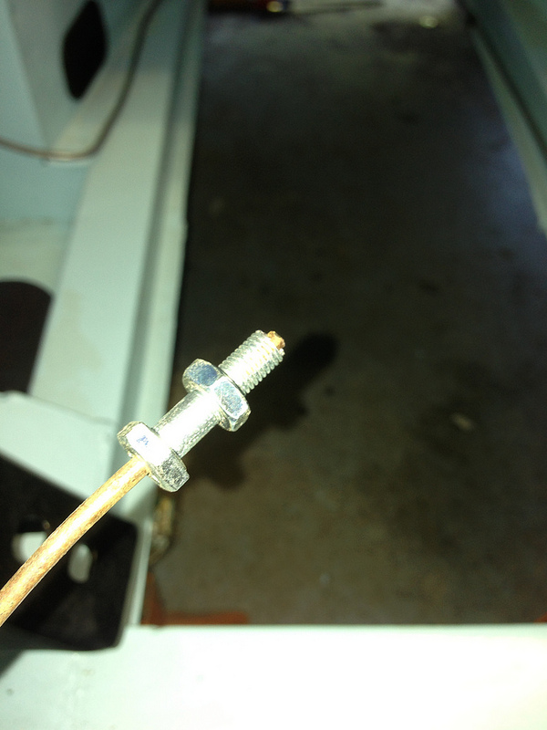

Bill was correct! The ends were rounded some in the carbs once I was physically able to run a bolt through a 1/4-28 worked like a charm! Drilled the center and this is what I got.
10061308634_e2dc902ba4_c.jpg I will braze or solder the pipe when I know I have the correct length.
Thanks everyone!
Paul
