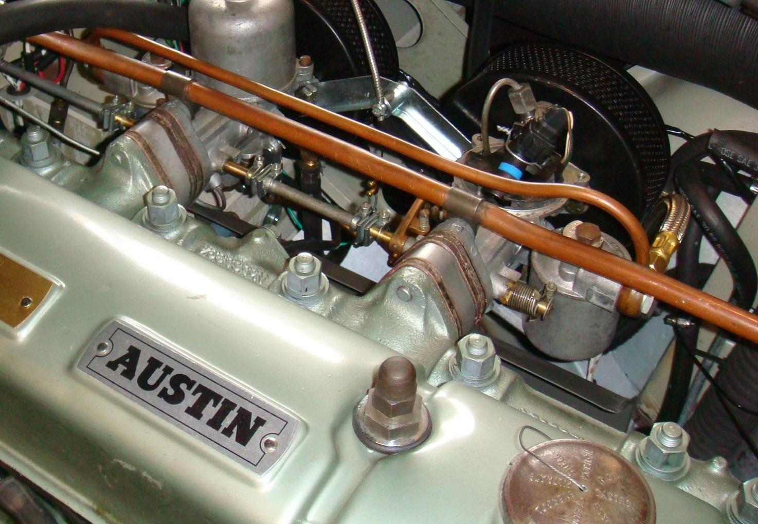

I still am toying with the idea of installing a electric ignition system because I want to achieve a more efficient fuel burn! There is simply too much raw gas not being burned with a stock system and I am looking for more fire in the hole for better gas mileage and power, not to mention cutting back on the gas fumes emitting from the tail pipe!
A friend of mine did some post grad research on emissions at uni and found that up to 25% of fuel evaporates before it gets to the engine when old cars are used infrequently. Every time the fuel pump runs at key-on it is replacing fuel that has boiled off from the float bowls and while we are driving along the fuel is constantly escaping as the air temp in there is around 140F which is above the boiling point of fuel. Unfortunately fitting electronic ignition won't really improve fuel mileage a noticeable amount, however it does improve cold running.
Stealth EFI fixes the evaporation problem, among others...
Andy.
