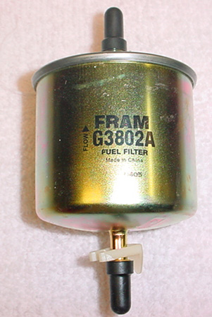

Partially true. Very few SU pumps have the "swamping resistor". Early ones had a capacitor/condenser & later ones had a diode. neither of these types have the resistor burn out problem.
The "big chunks" are definitely a problem & even small chunks will reduce the pump valve sealing ability. The small chunks will pass through & collect in the bottom of the carb float bowls. Some of them will cause float inlet valves to fail to seal. It is also true that a good filter will clog if enough small chunks collect in it. That's what it is made to do.
Lots of opinions on this subject.
If you want good filtering with long filter life, use a high capacity filter on the pump inlet. An example is the Fram G3802A shown in the attached pic.
