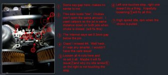

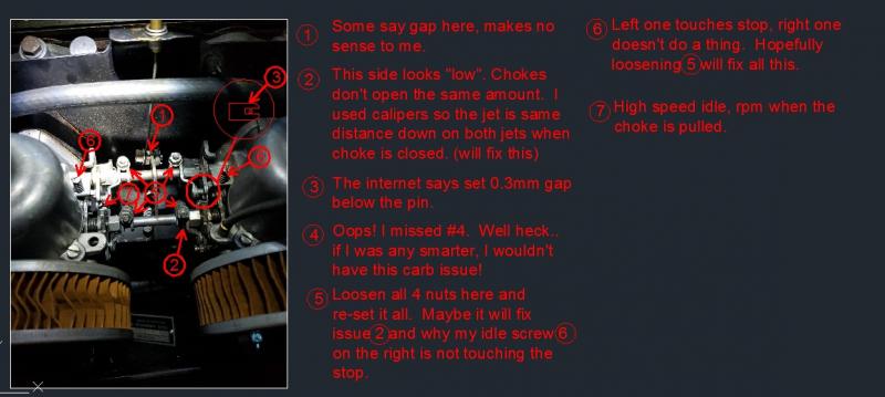

NEW PROBLEM! Car now idles high, 2000rpm. and I can't get it down. My idle screw on one side is not even touching the stop.
The jets aren't stuck.. They both move. one moves more than the other. I took out the piston to check the butterflies they look like they are matching. But whats T=0? Re-set the jets to 12 flats down.. Warmed it up, set the mixture, lifting the piston, etc... Now it's idling high and I can't bring it down. Online documents suggest loosening the throttle linkage nuts to set each side. Should I attempt that? I'm a bit overwhelmed by all the confusing gaps to be set (distance between throttle linkage and heat shield, etc, etc). Is there any straight forward way to do this?

Is the choke on? This sounds like it could be an issue with the cable and not the carbs. can you disconnect the cable - or slack it off a bit?
The choke is OFF. In fact, after looking at it for a while, I think my jets not coming up flush on one of the carbs is the result of the choke linkage not set evenly on the 2 sides (one is up while the other one is slightly down). But assuming they are in the fully choke fully OFF position, my left jet starts flush, go down 12 or 15 flats, check with calipers and match the second side to first side I should be okay. (only down side is when my choke is open, one side goes lower than the other.

It looks like you need to look for a good Utube vid for setting up SUs
With the jet adjusting nut all the way up (what I called T=0), the jet should be flush with the holder/ bridge. If not then something is holding the jet down. It is most likely the choke adjustment screw or the tab on the choke bar to the carb is set different than the front carb. This needs to be fixed first. The position needle in the jet controls the mix. If you are starting our with the jet down you are automatically rich to start with.
You are probably correct that the choke adjustment between the front and rear carbs is incorrect/slipped. Remember these are two separate carbs and need to be set up correctly independently and then connected.
When set up correctly both the choke and throttle on each carb will work the same.

I'll make another attempt this weekend if I can gather enough information on how to set the positions and gaps. I don't understand how they can gap between the throttle arm and the manifold heat shield. Internet says something in the thousands but I have a large gap. And also there is something about 0.3mm gap between the throttle linkage pin to the bottom of the jaw where it sits that lifts the last linkage that opens up the butterfly. If I can figure that out, I will loosen both throttle linkage and both choke linkages and start from scratch.
I am not clear what you are saying here? do you mean there is a gap between the carb and the manifold? in which case that needs to be addressed first.
Joe is correct, the carbs need to be set first and then connected.
Not sure how far you want to go with this, but, if you remove the carbs and take the SU's apart you might want to confirm that the needles match. However, assuming it did run and now you want to make it run again,
1. disconnect the carb linkage from each other ( test to make sure it is not binding)
2. Confirm that the butterflies both close fully.
3. adjust the needles the same number of flats.
4. reconnect the carbs
5. see what happens.

So my plan of attack
-Remove dashpot cover, Take off the piston/needle.
-loosening all 4 nuts holding the 2 throttles and 2 chokes.
-raise the jets on both sides via the mixture nut on bottom.
-tighten the linkage nuts to the chokes. (hopefully that will allow the chokes to operate evenly.
-push chock knob in (off)
-Lower the jets same flats on both sides (12-15) but I will check both sides with calipers.
-put the needle/piston back in, install dashpot cover.
-start engine and warm up.
-set idle and mixture on both sides. (1100rpm sound right? and doesn't this even's out the butterflies? or is there a different adjustment for that?)
-pull choke and set highspeed idle on both sides item 7 (screw with spring underneath pointing back and rides on choke cam). (what rpm am I looking for?)
-shut off engine.
-gap item 3 on both sides and tighten item 5 nuts for the 2 throttles.
Please let me know if this makes sense! thanks!

Yes your program should get you running
Some additional thoughts/hints
With everything loose and the jet nuts all the way up the jets should be flush with the top of the holder
Make sure the levers on the chokes touch at the same time when pulling out the choke. There is some slop in the levers. Not sure why you say push choke in. This should be done with the choke in.
With the throttle linkage tight start motor and warm it up. It is a pain to start it with the linkage loose.
After warm up with motor running Loosen the throttle linkage. Adjust the mixture
Adjust the throttle screws so that the two carbs are about equal, either a flow gage, listening through a hose for equal hiss or as close as possible by eye.
Tighten the linkage. Make sure the tabs are engaging the linkage at the same time.
This should put you in the ball park
Idle speed with the choke out is a matter of personal preference. I use about 1500 with a warm idle of about 1000-1100 (my cam does not like the idle any slower.
