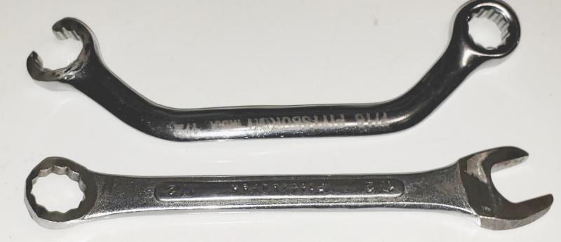

From below use a 1/2"deep well swivel socket on an 18" extension to remove flange nuts. The heat shield will make it almost impossible to remove them without removing the intake. I did drill holes in mine to allow me to loosen and tighten the nut if ever necessary. The Carbs have to come off using a 1/2" stubby open end to remove the heat shield. Use 9/16 socket on the lower exhaust manifolds, you can reach under and feel them to install the socket with a 6" extension. The upper ones are easier to see and remove. I have bought extra open end wrenches at garage sales in the past and used a sawzall to cut them down to 1-2" long-much shorter than stubby wrenches available commercially.

Don't worry about taking off both manifolds - you'll need new gaskets anyway. I modified these cheap HF wrenches for carb nuts.

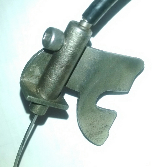

Notching the choke cable brackets makes them easier to remove and reinstall:
I tack welded nuts to my choke brackets. that not only makes the brackets easier to R&R, but the nuts too.

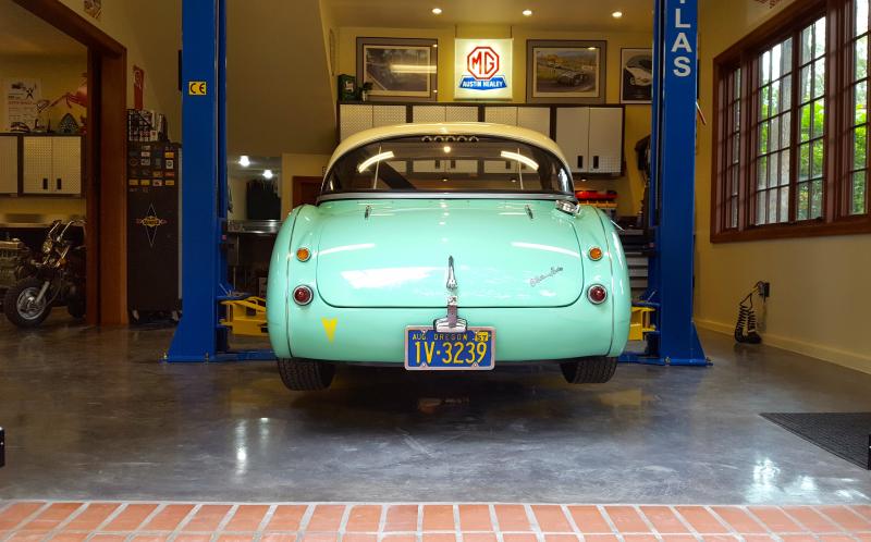

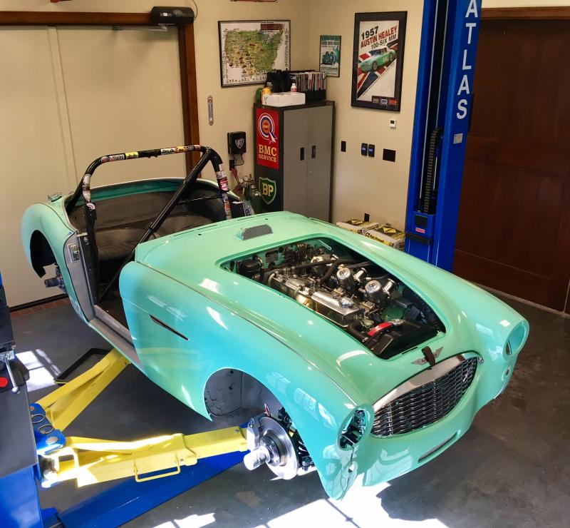

Hey Crispy -
I didn't see you were in Portland (Go Blazers) I could have set you up with everything you needed and a lift .......I'm in SW near Lewis & Clark College. My lift is still the available to you if you want PM me.
