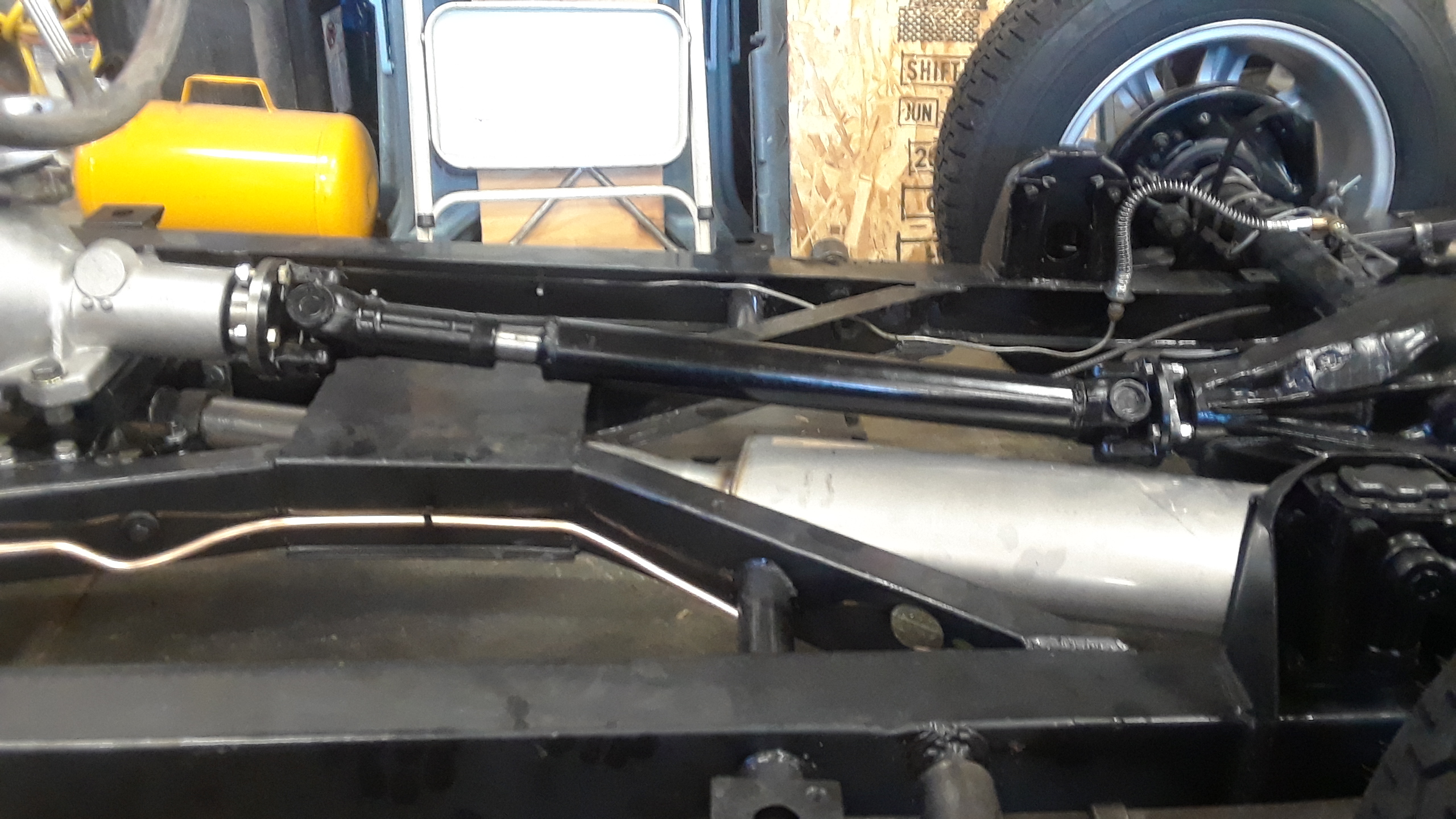

The 812-020 is the stock hanger for the TR3. What is not shown are three bolts with washers and nuts. One for the middle and two, one on each end. Those two end bolts go through the frame and those rubber buffers ( two per bolt). The holes in the frame for those bolts and buffers are forward of the center frame section. Truthfully you will need to separate the exhaust pipe to get this hanger on the pipe. Also note that the hanger has a front and back. This is noted by the angled ends that the two bolts go through. It is a real PIA to get installed. I recall it took me a number of hours to do But it does allow you to get the rattle stopped. I am including a pic that barely shows the installed bracket on the very left. 20210718_165854.jpg It can be seen under the rear of the tranny. Note the bend in the fuel line around one of the outer bolts that go through the frame for the bracket .
