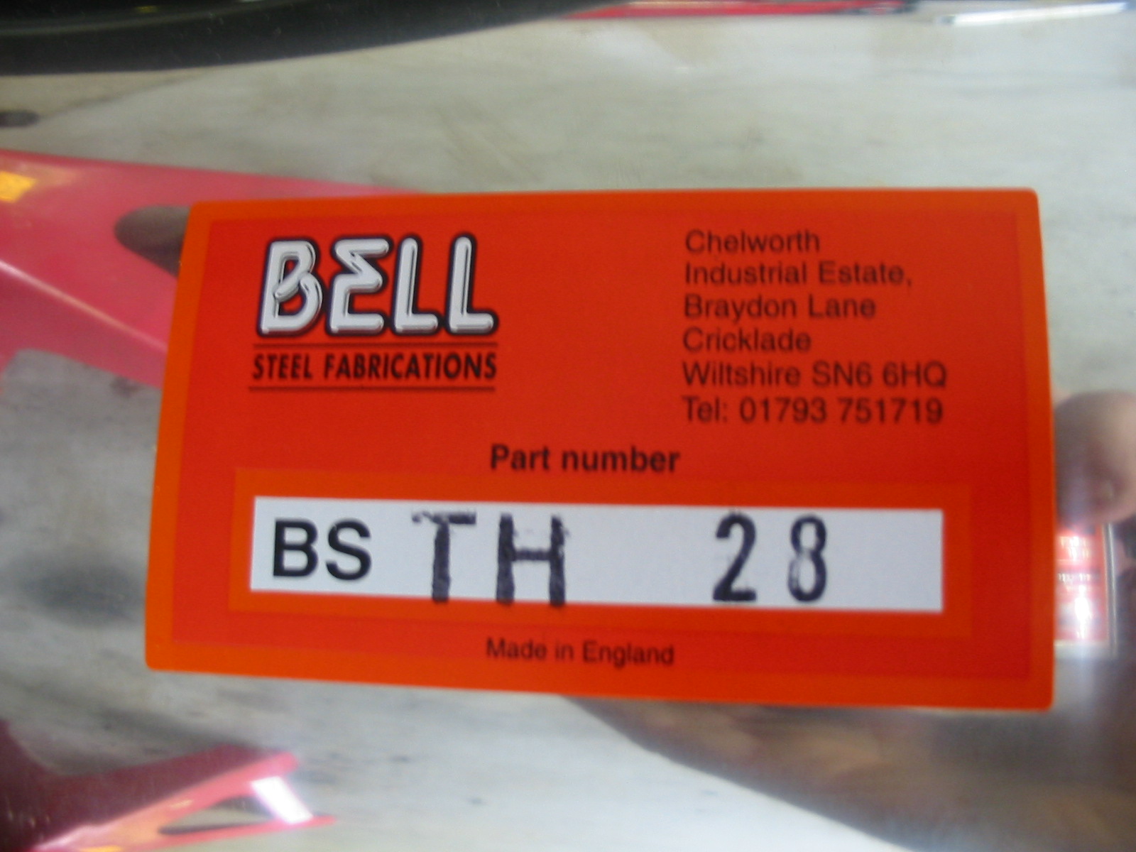

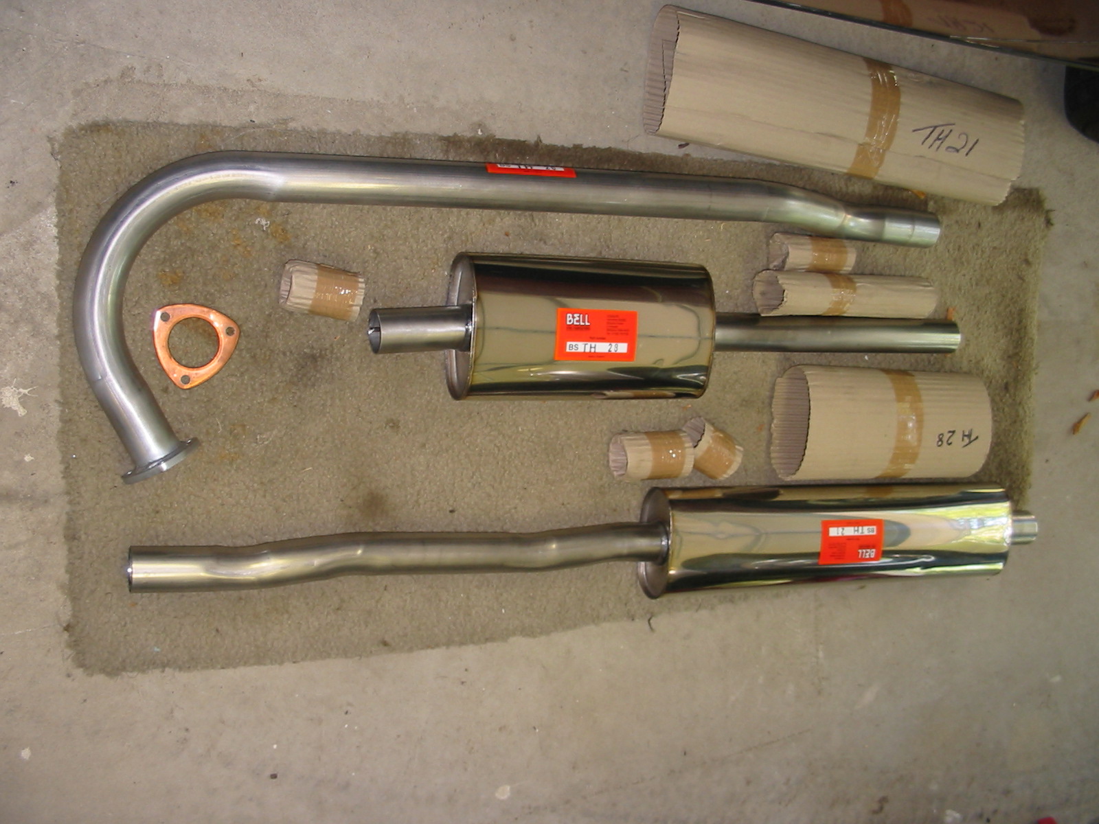

I put a Bell system on my car. It is polished stainless steel and is configured with muffler and resonator, same as original. It has the same sound as OEM equipment. Fitment was easy and looks very pleasing on the car. I bought it from one of the performance/restoration shops in England and price was not unreasonable.

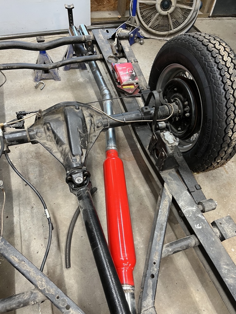

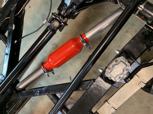

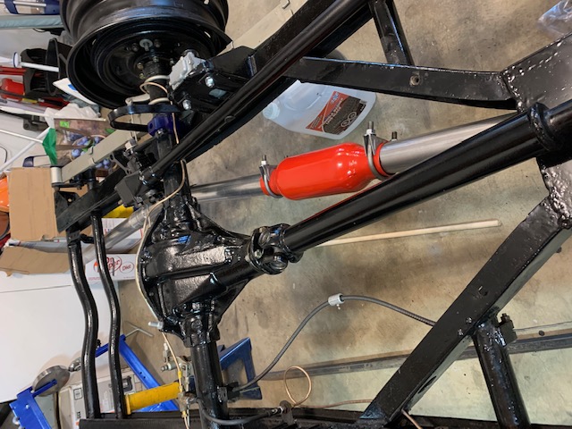

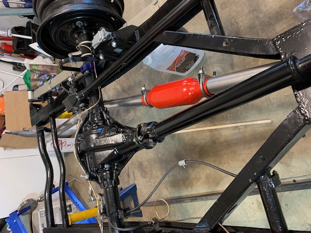

As stated - it's a personal preference. But me? Well, I like loud and mean. My TR3 is black with TR6 black wheels (fat tires) and I want it to sound deep and mean! so I put in a measly little 8 inch Cherry bomb! It only cost about $60 bucks and I was able to get some two inch exhaust pipe from Canadian tire and put it together for cheap.
