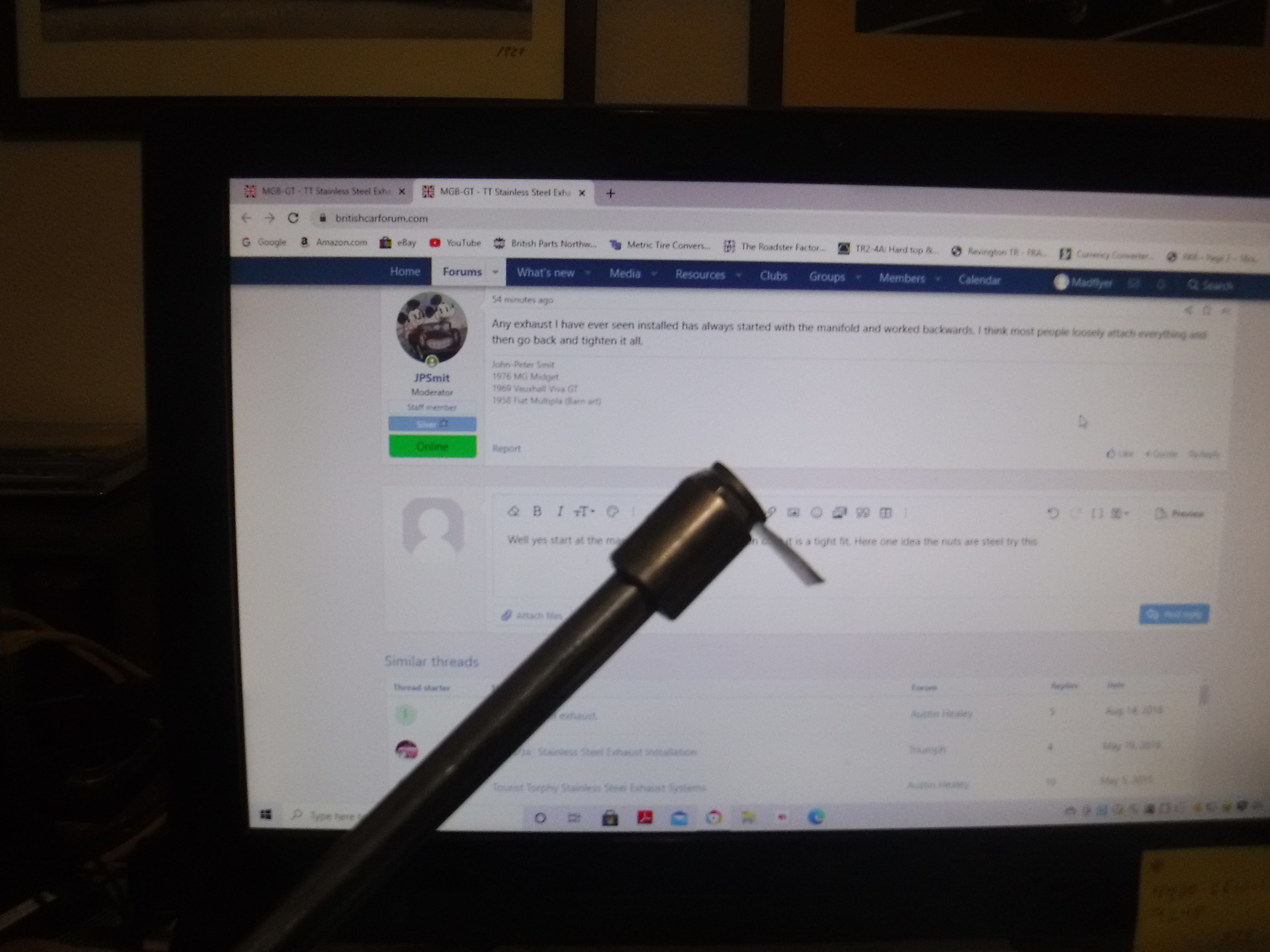

Well yes start at the man. if the studs have not been bent it is a tight fit. Here one idea try this
I put two nuts in socket added a strip of dlb sided tape and stuck lock washer or any washer, slide up to man stud brake tape turn three threads pull out second nut start over three more times. Now tighten evenly donut should stay true. The studs next to block darn tight fit . GOOD LUCK
Pic shows washer stays even at full tilt.
