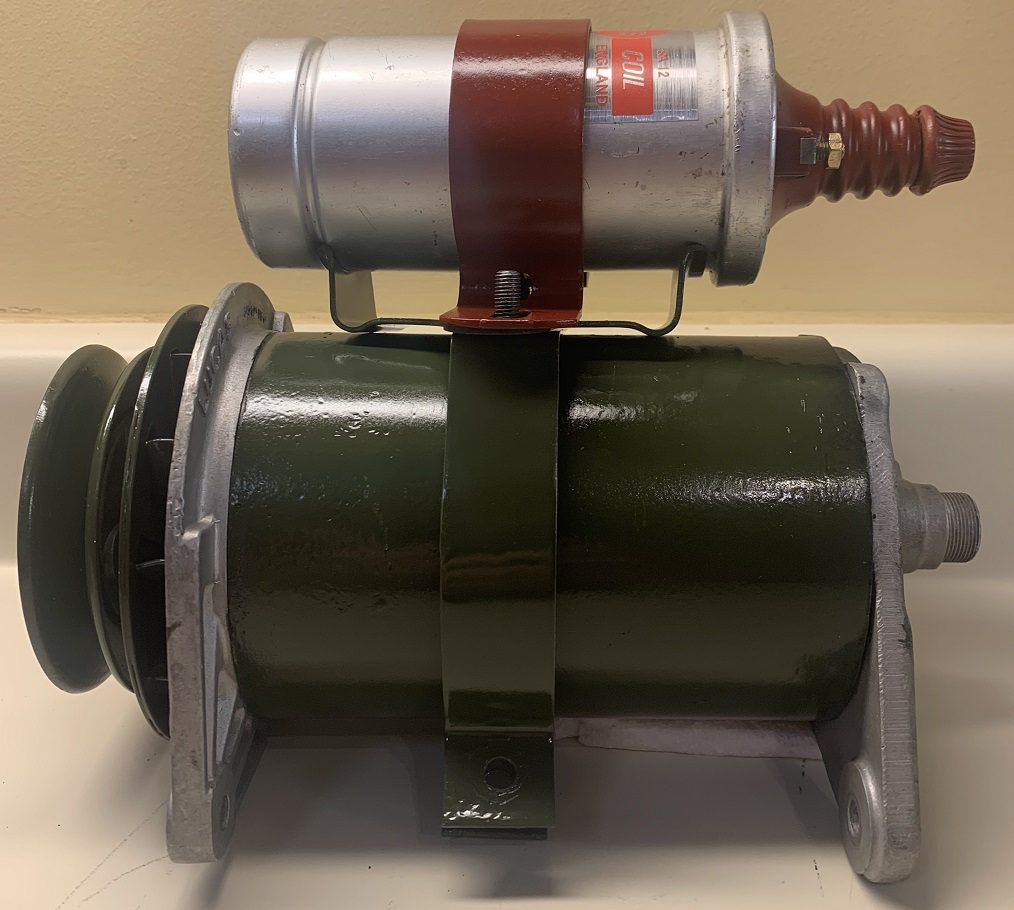

While reading through the Concours Registry yesterday I found some that just doesn't seem correct. It says that, for the early coils which were mounted on top of the generator, the coil clamp bracket was painted red.
From Chassis number AN5/501 through Chassis Number AN5/11888; the ignition coil was mounted on top of the dynamo (genetator). The dynamo clamping bracket was painted engine green. The ignition coil clamp bracket was painted red. The ignition coil was fastened to the dynamo bracket by two zinc plated hex head bolts, washers and nuts. From chassis number AN5/11889 onward; the ignition coil was relocated to the right hand wheel arch gusset plate. From this change point forward, the ignition coil bracket was zinc plated.
Anybody ever seen a coil bracket painted red?

Yes, the early ones were painted red.
Refer to the photos and/or video of David’s car 501 on the Bugeyeguys website for an example.

NOS generator re-painted engine green with restored Lucas Sports coil and red bracket.
I wonder if it had to do with the parts bin it came out of. I am sure you have other parts (in my case painted shocks) that made it easy for the assembler to identify the correct one.
