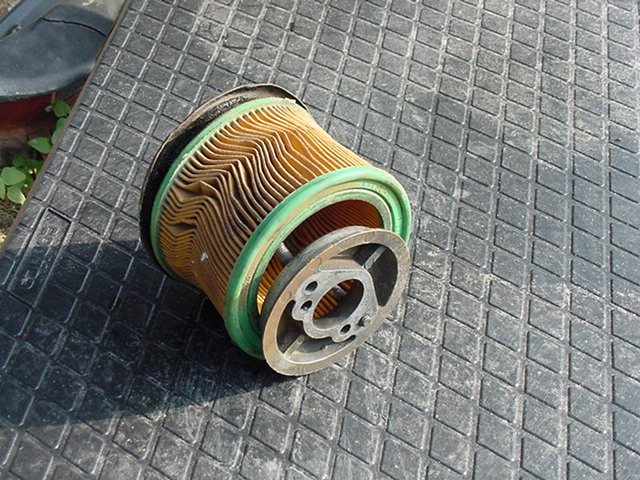

What!! You mean I have to buy another car for a clutch line? Well I guess that stands to reason. Besides I found that another part is missing also. On one of the SU Carbs. there is a plate that goes between the Carb. and the air filter that is missing. I can see that none of this is going to be easy. Do many cars come up for sale that are in varring stages of restoration that were in good running condition before the owner started working on it? I can see this could be very possible.

Tom_Odom
[ QUOTE ]
If you don't have a parts car, I probably have them in my used inventory.
[/ QUOTE ]
Thanks Tony, Will try to attach picture. Jack might to take a look. Tony if you have one of these plates I think I could use one.

tony barnhill
Great Pumpkin - R.I.P
Yeah, I need a photo of the part you're calling a 'plate' - can't visualize it.

Tom_Odom
[ QUOTE ]
[/ QUOTE ]
Tony, I thought I had an attachment in the other post. Check the attachment.

jlaird
I would suggest that that is an aftermarket air filter baseplate.
tony barnhill
Nope, Jack - that's the backplate adapter....works sort of like an ait horn....yep, I've got lots of them!
Sorry I didn't see the attachment first time.
& what year clutch line do you need?
