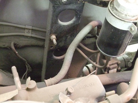

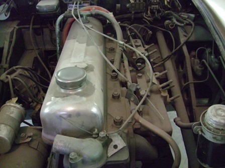

I am installing the brake/clutch fluid reservoir of my BT7 and I need to know which line connects to which nipple on the bottom of the can. I assume the inner compartment of the reservoir feeds the clutch and the outer compartment the brakes because the outer is larger and will hold more fluid. Am I correct? Or does it matter?
vette
Maybe this will help. You can just see the lines at the Master cyl.

... I assume the inner compartment of the reservoir feeds the clutch and the outer compartment the brakes because the outer is larger and will hold more fluid. Am I correct? Or does it matter?
Your assumption is correct. If it didn't 'matter,' why would they bother increasing the cost and complexity of the reservoir by designing it with two chambers?
Keoke
"I assume the inner compartment of the reservoir feeds the clutch and the outer compartment the brakes"
Yep you right Rob
. But guess what :
They work either way en don't ask me how I know.-:friendly_wink:
steveg
The two chambers are necessary so if you have a leak in your clutch circuit, your brakes don't fail.
