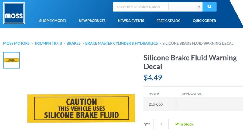

Your restorer should have put a DOT 5 label near or on the reservoir:
Yeah that sounds like a good plan, there can't be much DOT 4 in the res. My restorer probably told Me and I forgot, after so many LBC's I just defaulted to Castrol DOT 4 .
