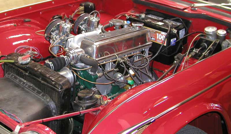

Hi guys - picking at the TR4a IRS again and need some help on the fuel lines. Specifically, I am looking for correct routing of the fuel lines into the pump and then from the pump to the carbs.

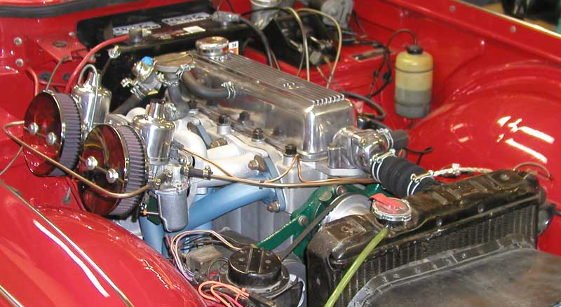

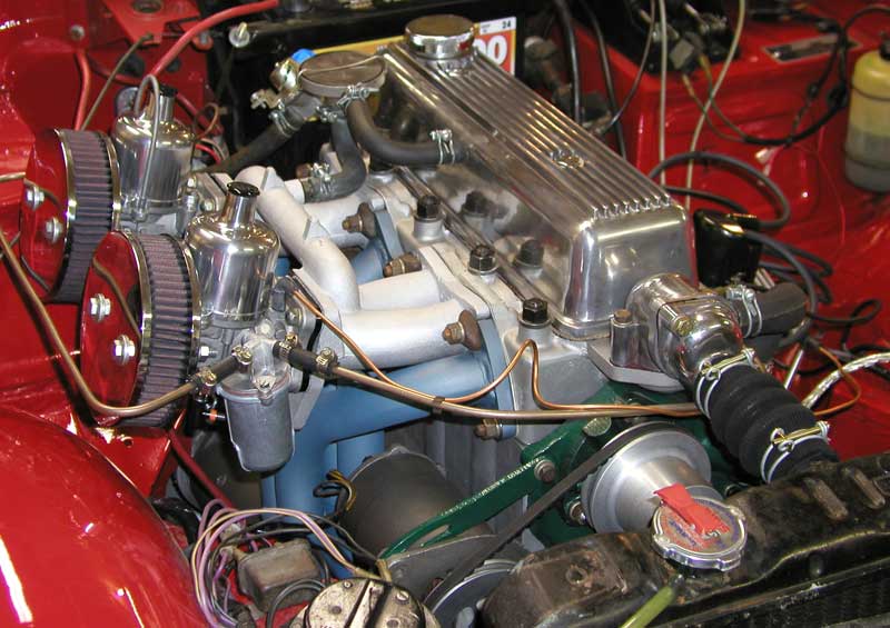

I think these are correct, though not original. The tube between the carbs should be clamped to the air cleaner bolts, and ignore the loop in the vacuum line.

Thanks guys - very much appreciated.
She has SUs, so the end point is a bit different but not much. It looks like there is a single metal fuel line that makes the run from the pump to the bowls. I don't have that section so I'll have to fabricate one.

HerronScott
Tom,
As Darrell said the carb to carb section should clamp to the air filter bolts, but I routed mine underneath similar to Jim's pictures as I used Weiand air filters instead of the paper elements.
