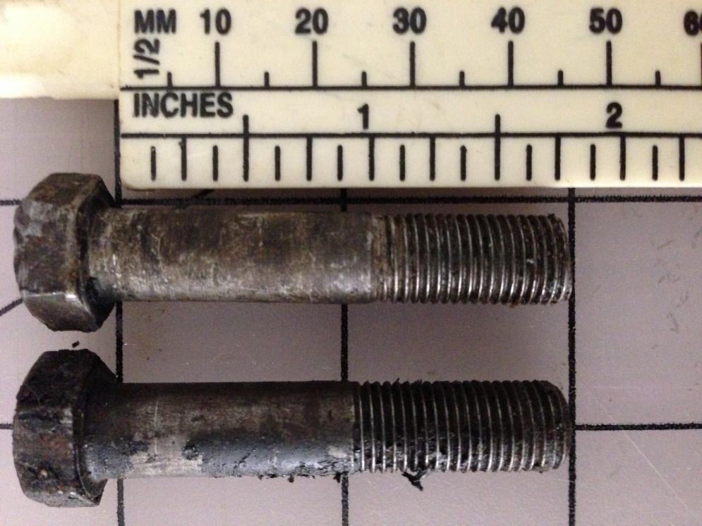

markberry
Hi Paul,
you're in luck, my steering arms are off so I was able to measure the bolts for you. The grip length was the same on both bolts however one bolt is 1 7/8" long and the other is 2" exactly
hope that helps.
mark

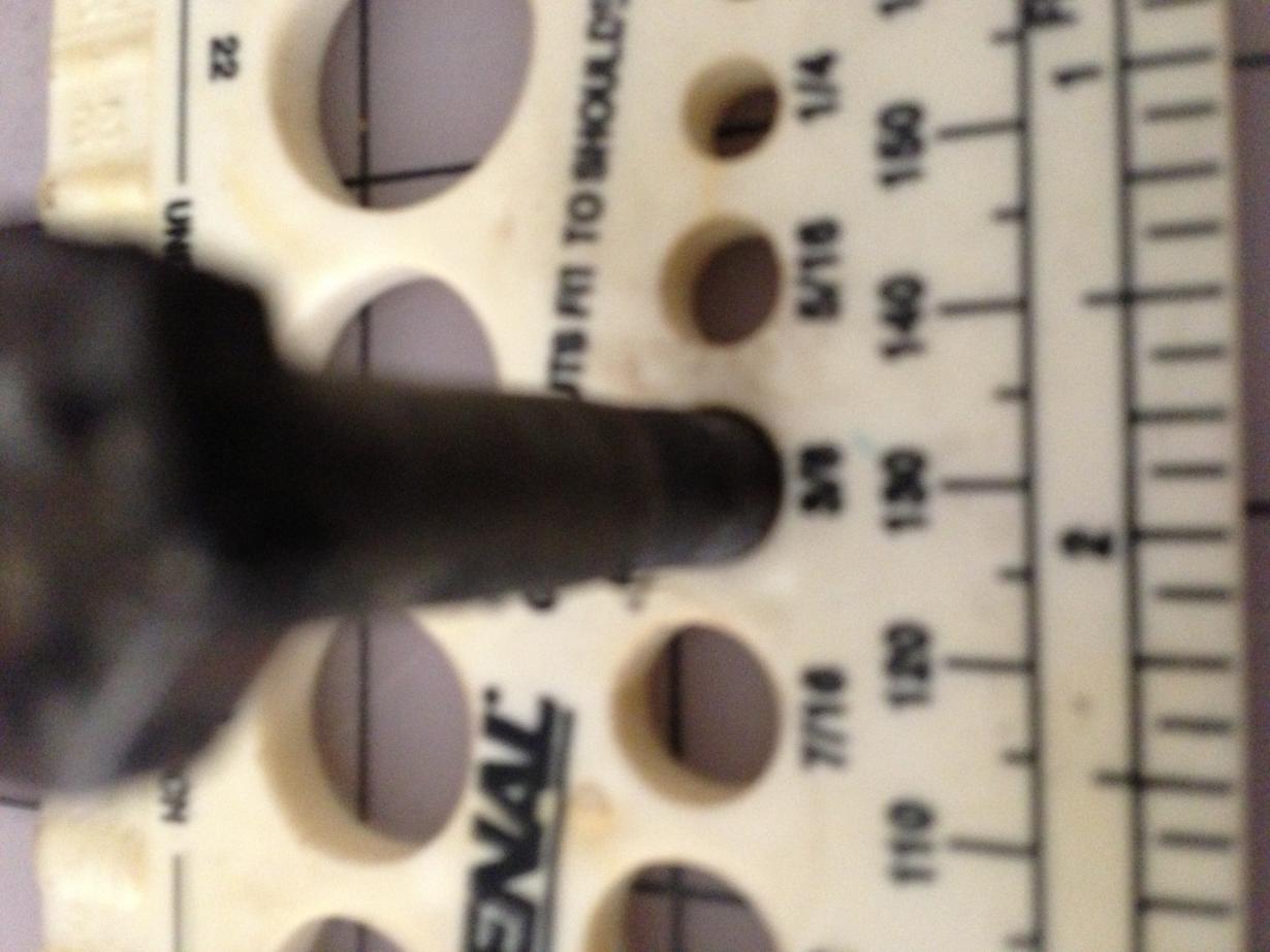

paulsherman
As a TEMPORARY fix, I used 3/8-24 bolts X 2" long. I did see that Victoria British has these bolts listed: #18-242 (short) and 18-243 (long) and the locking tabs #18-240.I did go to a nut and bolt store yesterday and they told me after an extensive search that the could not find such bolts anywhere. I will dig thru my parts bins to see if by chance I can find the old bolts. If not, I will VB or other sources later.
