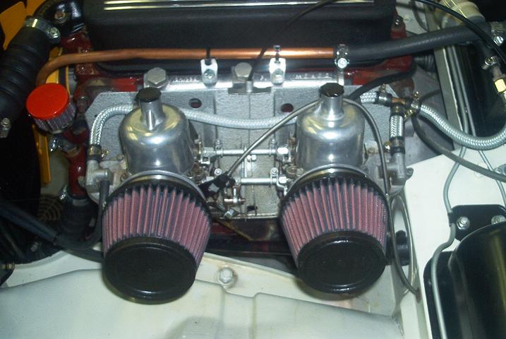

WE been wrking on a a aluminum billet velocity stack for the HS2 for awhile, it's been a back burner projects, but now it down to waitng for dleivery form the CNC source, all the homework is done, it fit under the hood fo Bugeyes, Square bodys and would be used woth the K&N Ru-4410 air filters. It a proven better flowing set up than anyhting else offered, and for someomen that like things simple the KN RU 4410 cone filter, no back or fornt plates to deal with, no studs running thru the air flow, the air filters is held on with a SS hose clamps that comes with the filters, so getting access to carb is as simple as loosening the clamp and removing the air filter ( a 2 second job). We been using this set up on the MGBs for awhile and the racing Spridgets w/ dual HS4s, and the racing MGB with HS6 and HS4s (we already make aluminum billet stack for the HS6s) now we have them for the HS2s as well, I should have my stock of them in a couple of weeks at the most, they will sell for $59.99 a pair, and the KN filter are around $30 each, and can sourced just about anywhere, I got mine at Summit racing.
The first picture is a set of HS2 with the aluminum radius stack, and the second picture is my MGB with the KN RU 4410 air filters.
This set up is not a fancy as some of the set up, but it flow better than the rest, and it very user-friendly when it comes to working on the carbs, that why we racers have used this set up for years.

Thanks Hap, I remember a while back when you asked if there would be any interest in these and I'm pretty sure I said I would.
That's what I did with my last B too, and I agree it really helped and was a pretty elegant solution.
I think I can hold off until these are available for the HS2 - I hope you will be getting enough stock so everyone can get some!
A buddy and myself contracted to have 20 sets (40 stacks) made, and we'll get more when these run out.
