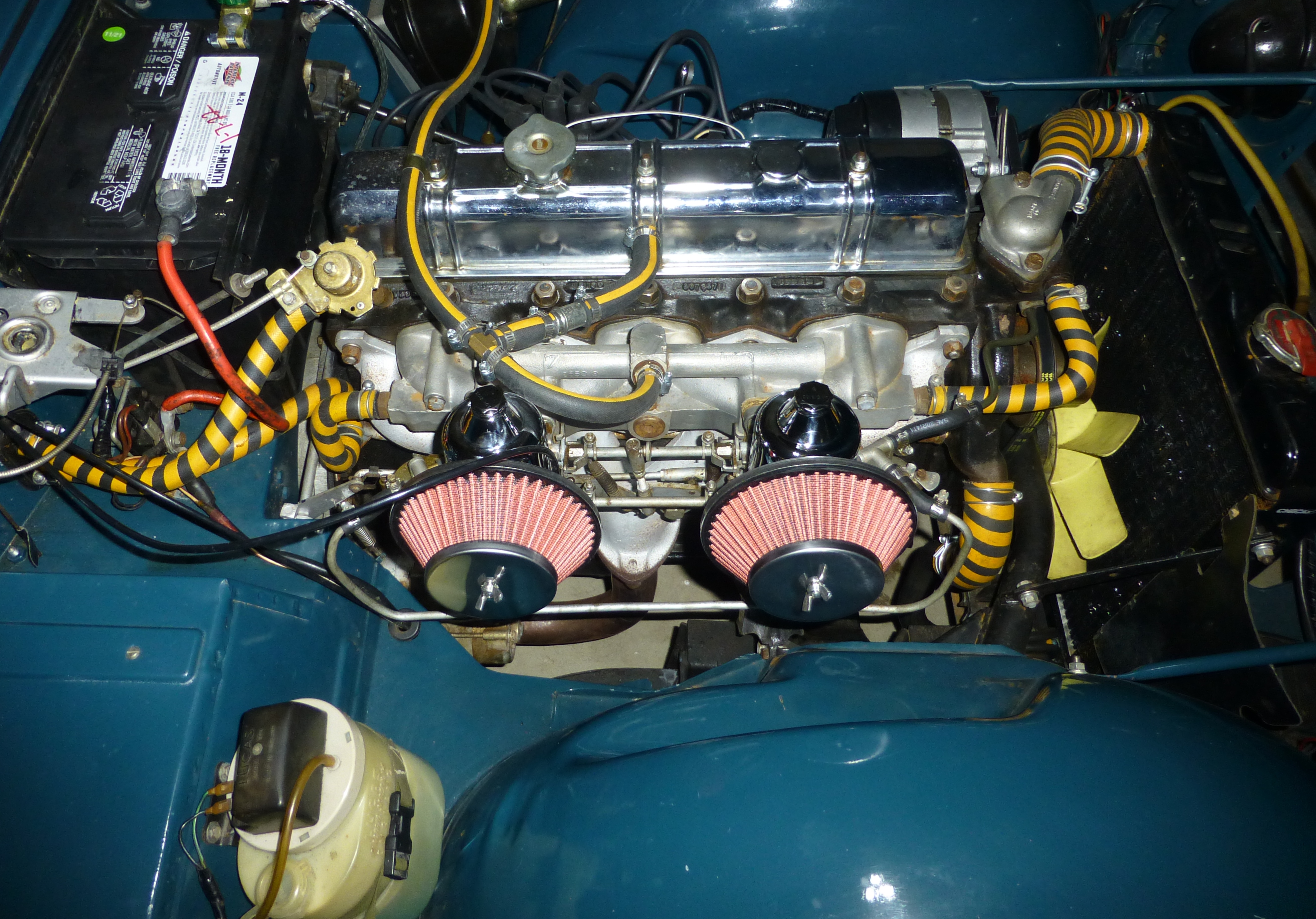

I put a set of these on the 250's HS6's, un-oiled. So far so good.
JHaydon

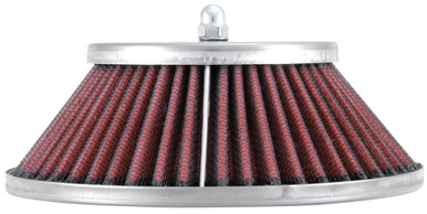

"with these washable and oil-able filters"
The K&N which those replace (according to the ad) were also intended to be oiled prior to use. K&N made their own oil specifically for cotton-gauze filters.
Dry is a lot better than no filter at all, but oiled will be even better.
