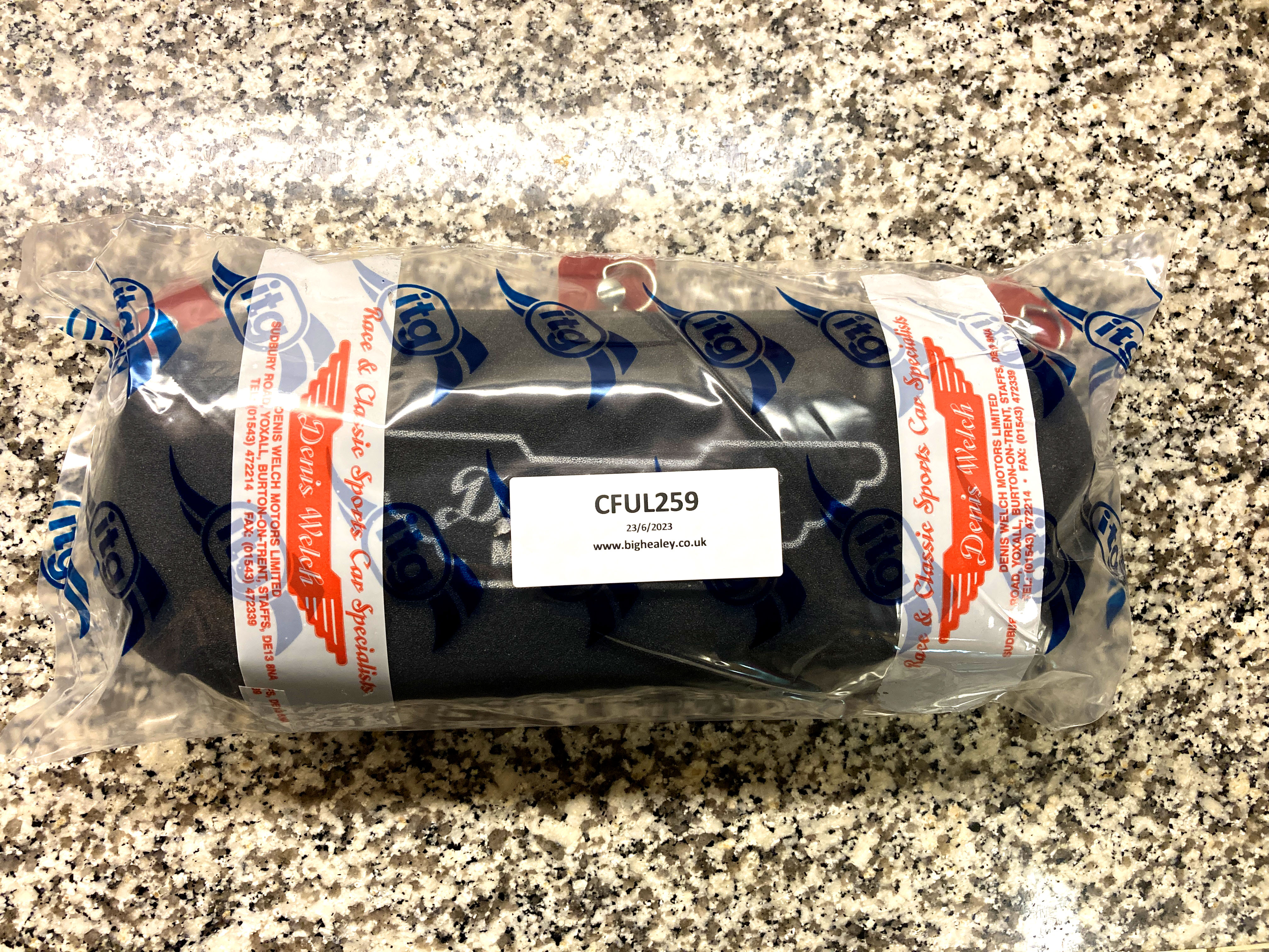

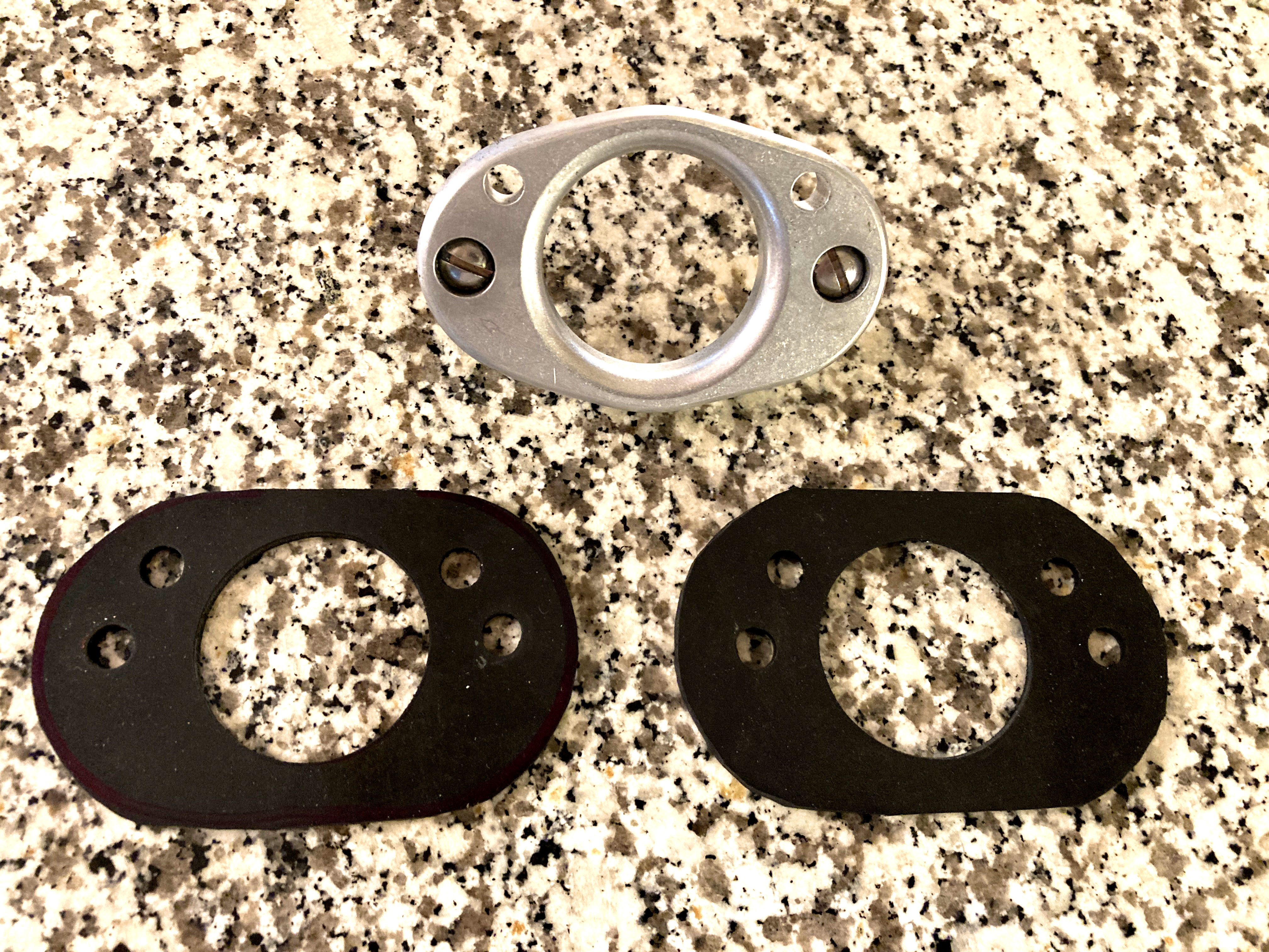

I have not verified a power increase, but the the sub stacks used to mount the ITG filter on our BJ8 have made a nice improvement in idle smoothness and throttle response. Picture 1 shows the sub stacks. The two mounting screws have had their head turned so they are a press fit into the sub stack. Afterwards, the screws are pressed into the sub stack with a light coating of intake epoxy . Once cured, the screws require a press to be removed from the sub stack.
Additionally, the mounting screws are longer than stock and the two inside nuts can not fall off the screw if they become loose (they are retained by hitting the carburetor). Longer screws were used so their tips could be drilled for retaining clips. Obviously, if the worst did happen and the sub stacks become completely loose in the filter housing, they are too large to enter the carburetor.

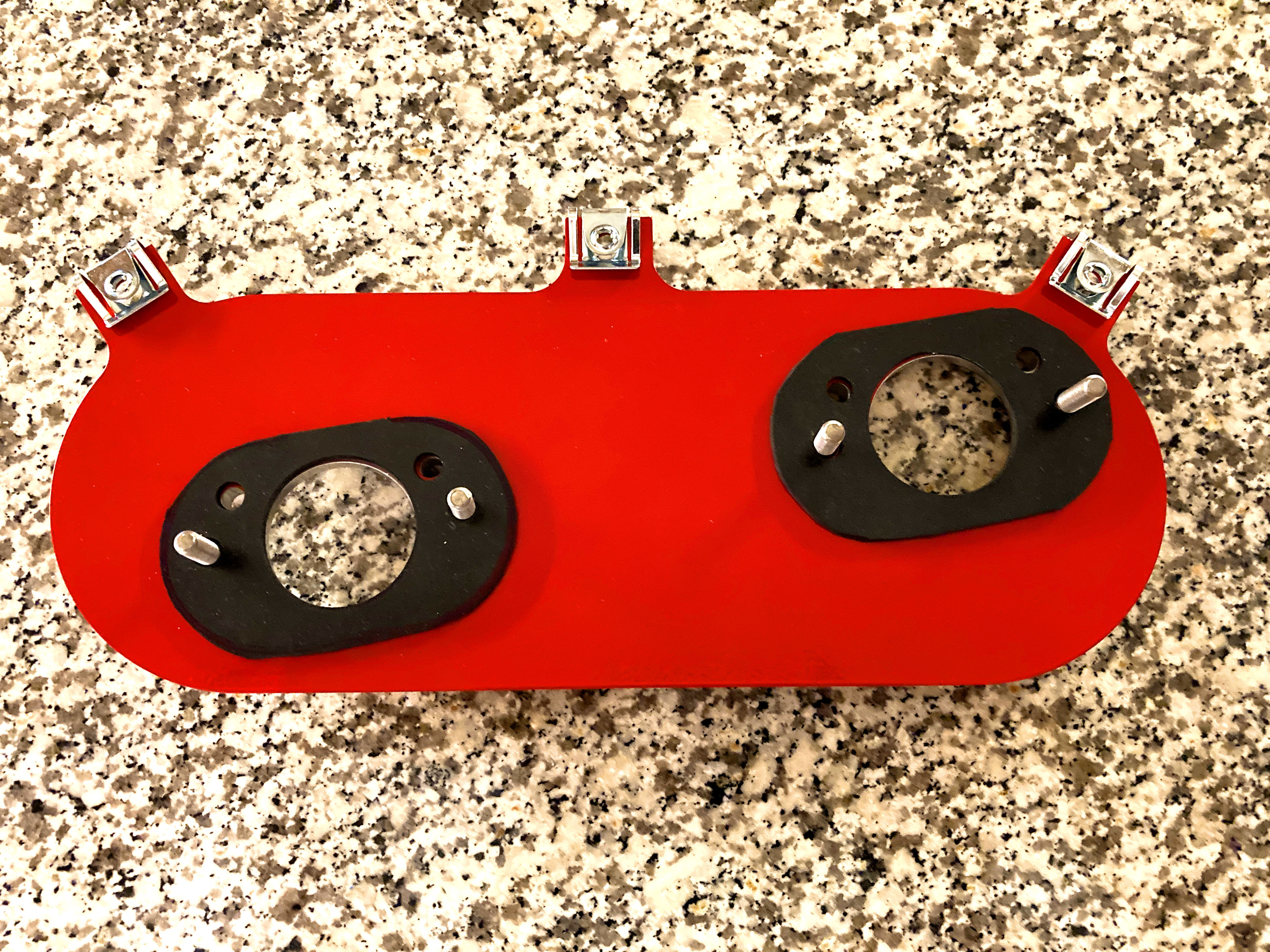

The two black spacers shown in picture 1 are cut from 1/8th Nitrile and replace the hard, white spacers provided in the kit. Unlike the white spacers, the Nitrile spacers are flexible enough to provide a good seal between the carburetor and the filter housing. Thin spacers are needed to provide clearance between the filter housing and the choke cables/springs.

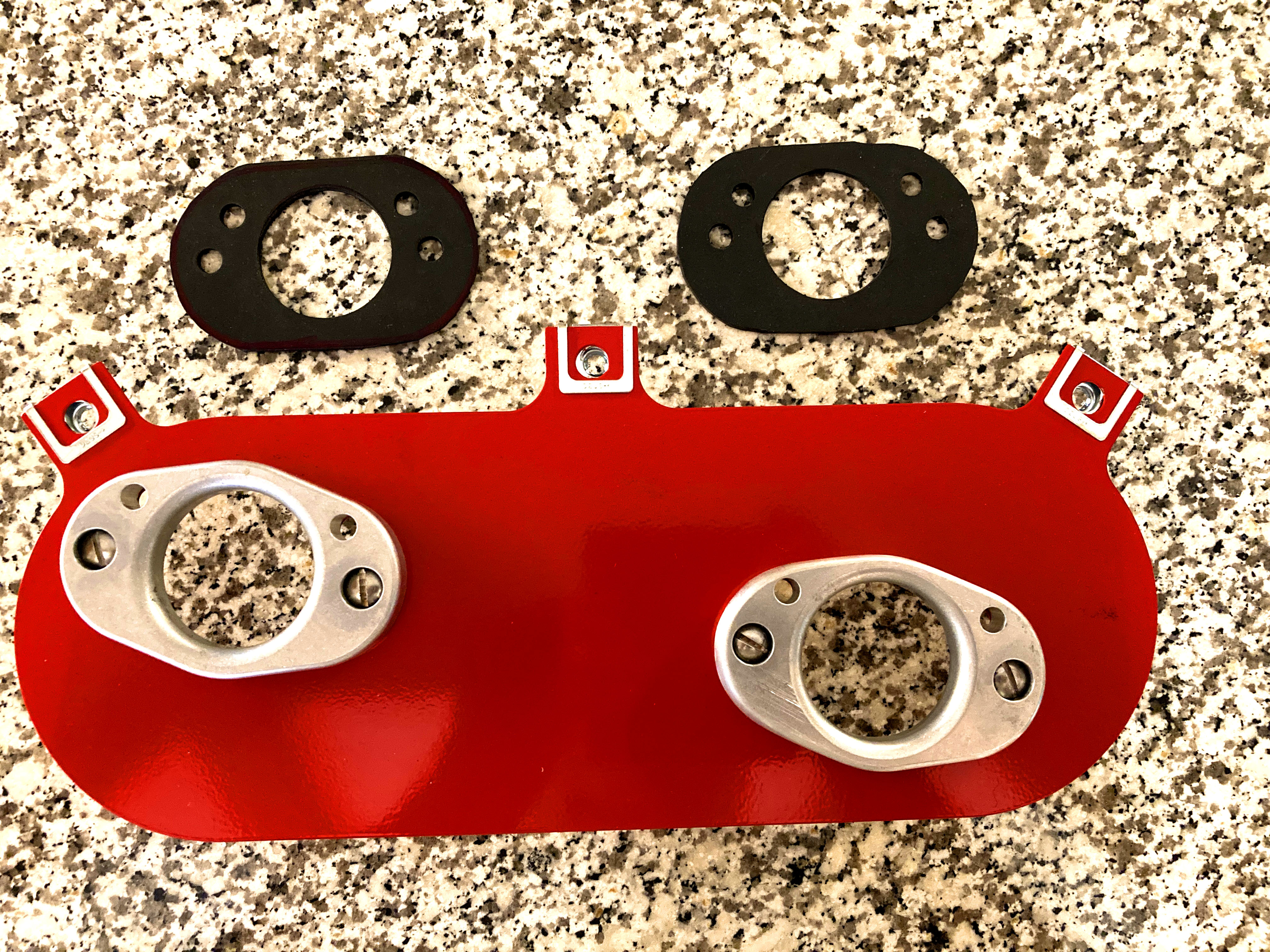

Picture 2 shows the sub stacks mounted on the filter housing, and picture 3 shows the Nitrile spacers on the backside of the housing. Picture 4 shows the filter element.
