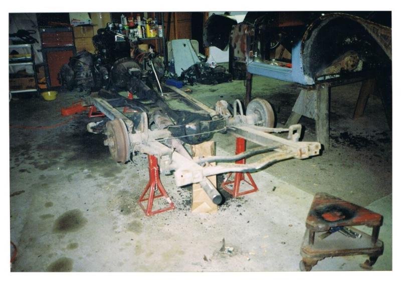

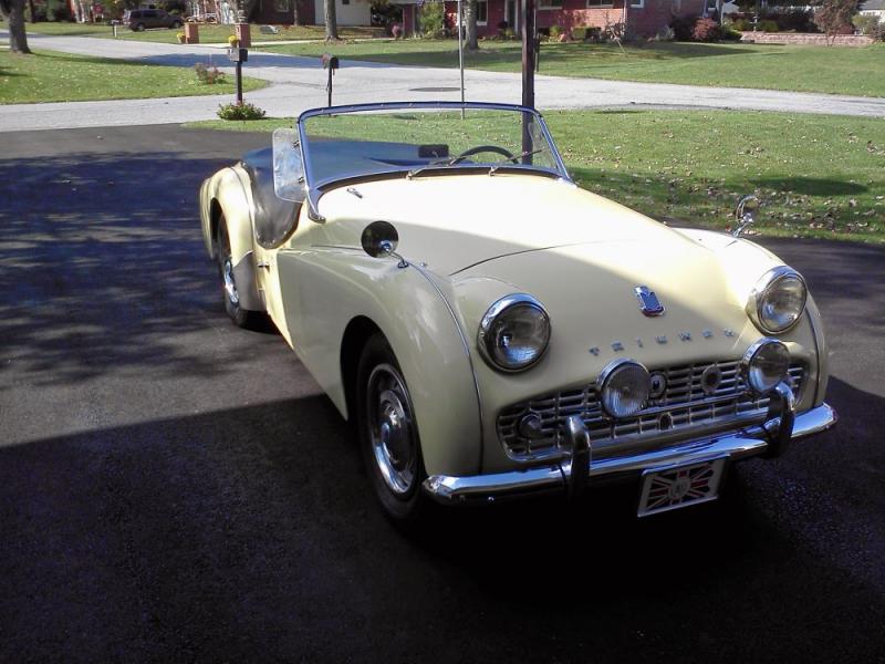

My car is TS33077L; there is a good chance that mine and yours were made on the same day. The first photo was taken when I first started tearing it down ... it was not quite as good as the one you have. The second is what it looks like now. I am not a mechanic but I learned a lot during the journey. If I can do it, you can do it. Keep posting pictures of your progress, I am keenly interested in watching you bring it back. I took a lot of pix along the way so if you need any reference photos during your work, tell me what you want to see and I'll try to send them to you.
