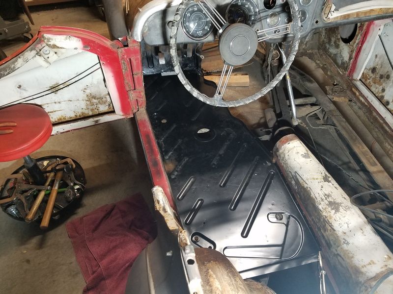

I had a little repair patch work near the bulkhead that went well. Was able to get the drivers floor trimmed and set in place. I am trying to figure out how to make a patch for the early style rear floor section. The PO hacked out everything so I have no reference. Been trying find a photo of how the panels should overlap. Any photos / direction would be appreciated.
Okay, I had to abandon photobucket and sell my soul to google. Hopefully links are working again. I have been able to make some progress on the floors, battery box and suspension.
Had some excavating around the drivers b-pillar. I was able to get to the inner sill and make the requisite repairs.
Got the driver side suspension broke down and have rebuilt and replaced just about everything.
Was able to separate the axles by building a tool, using instructions from this site. Came apart no problem.
The passenger b-pillar had some questionable repairs.
So I just cut it all out, inner sill was solid in this case
