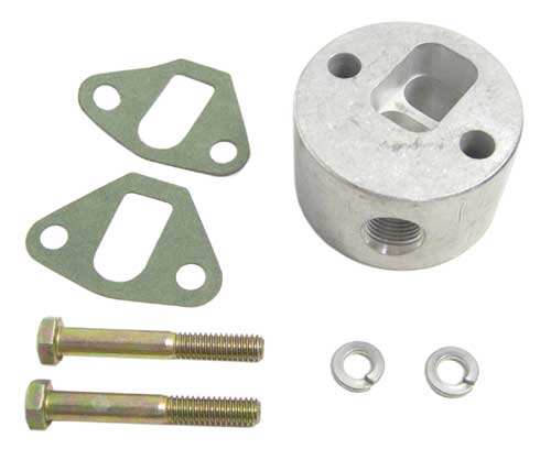

If you don't have a breather can on your timing cover and in fact you do have a 1275, then someone may have used a early 948 timing cover in the build of your 1275 engine. If someone then connected a hose from the dipstick tube to the valve cover tube, what they effectively did was not allow your engine to have any crankcase breathing, not a good thing. Go back with the dip stick in the dipstick tube and use the vent from the valve cover to vent for starters, it would nice if you had the correct timing cover as well. Some, not all 1275 engine on the front lower driver side section of the block have a machanical fuel pump block off plate, if you're lucky and your engine has this removeable plate, then you can buy a aluminum piece for Mini Mania that allows you to vent your crankcase from this area, which is way better than any of the original factory offerings, might be something you want to look into.

While we are looking at the venting, has anyone else had a problem with the front cover cracking around where the breather attaches and leaking oil? Hap, do you have a picture of that breather that goes where the fuel pump was?
