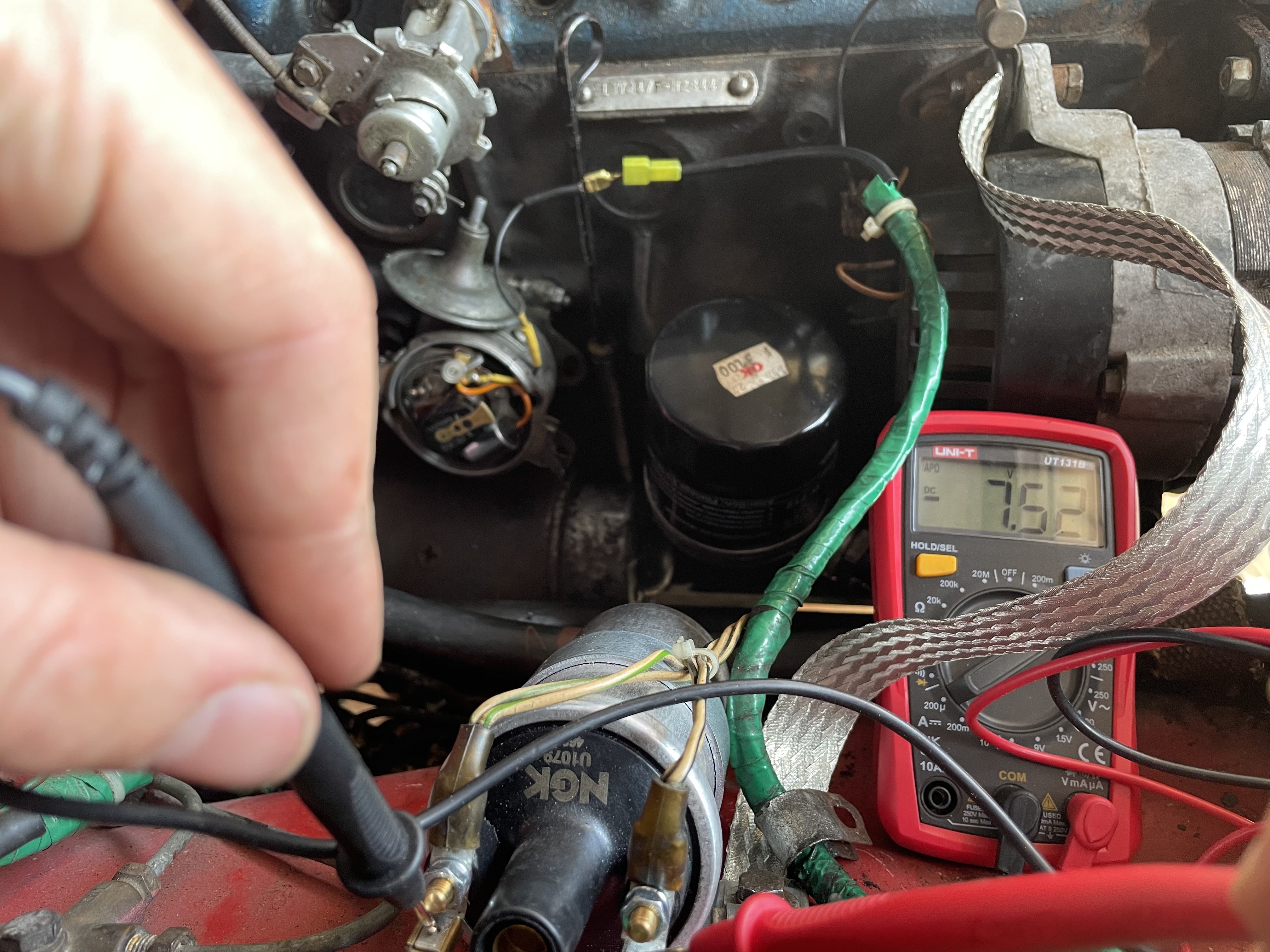

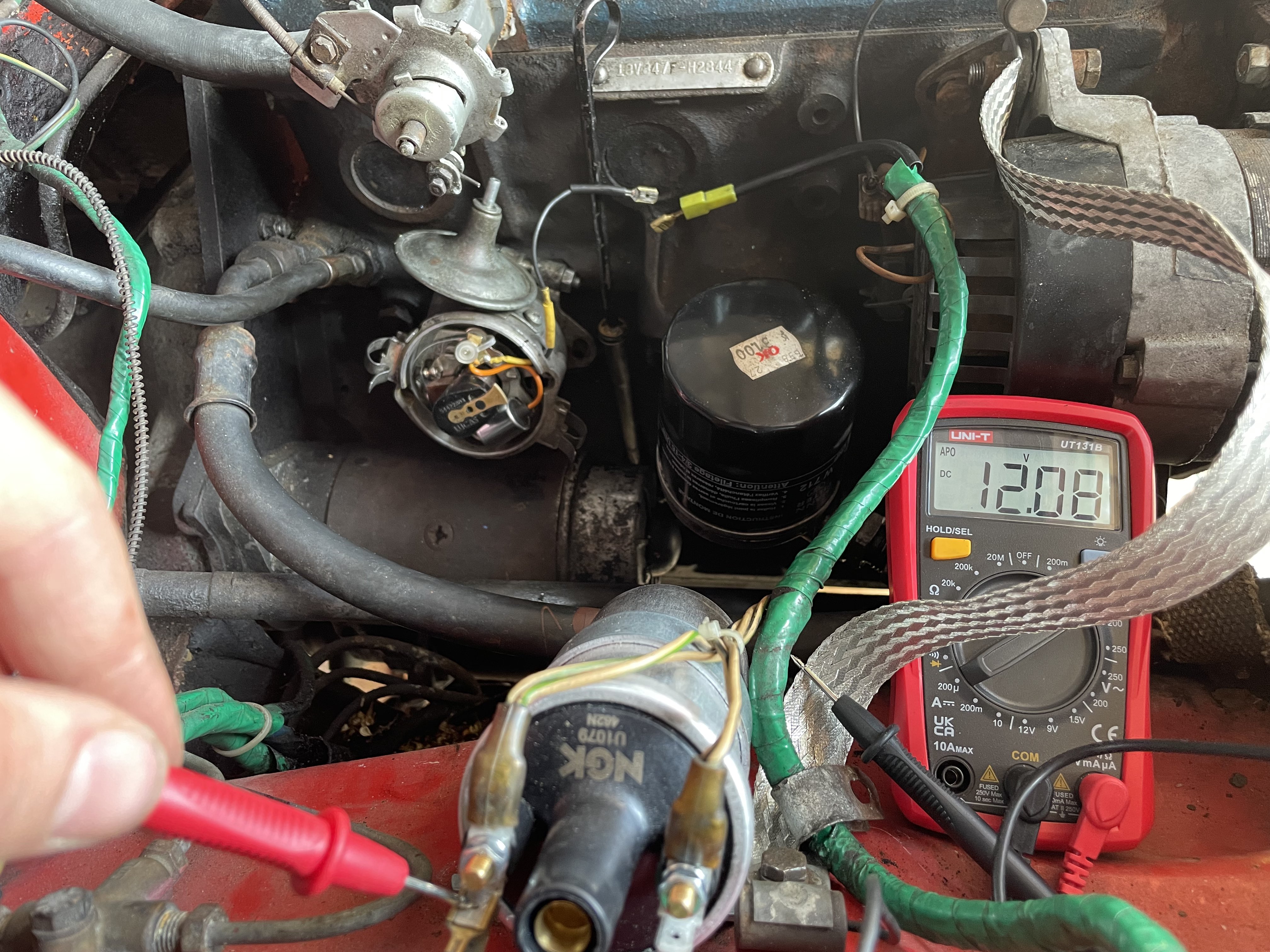

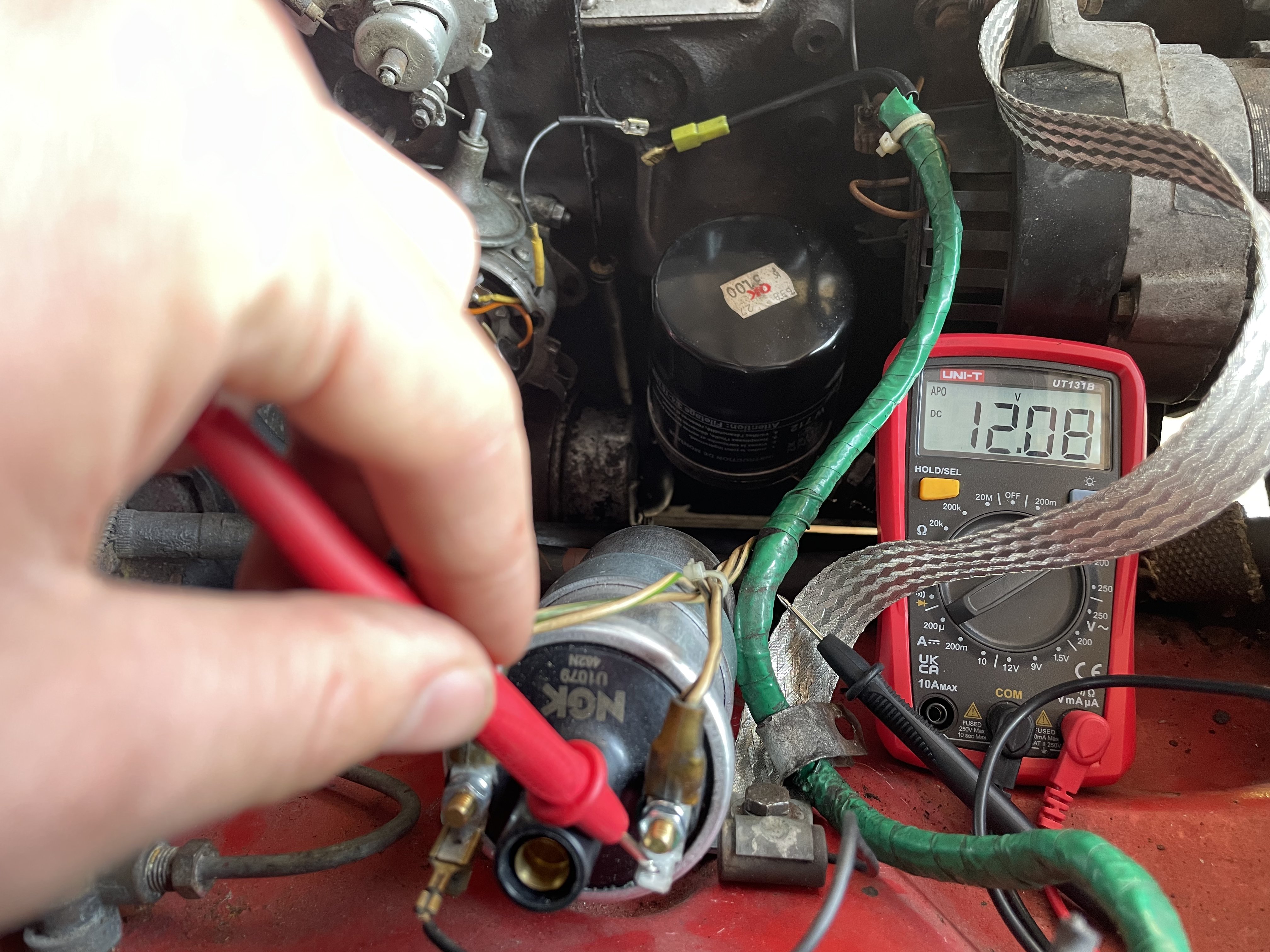

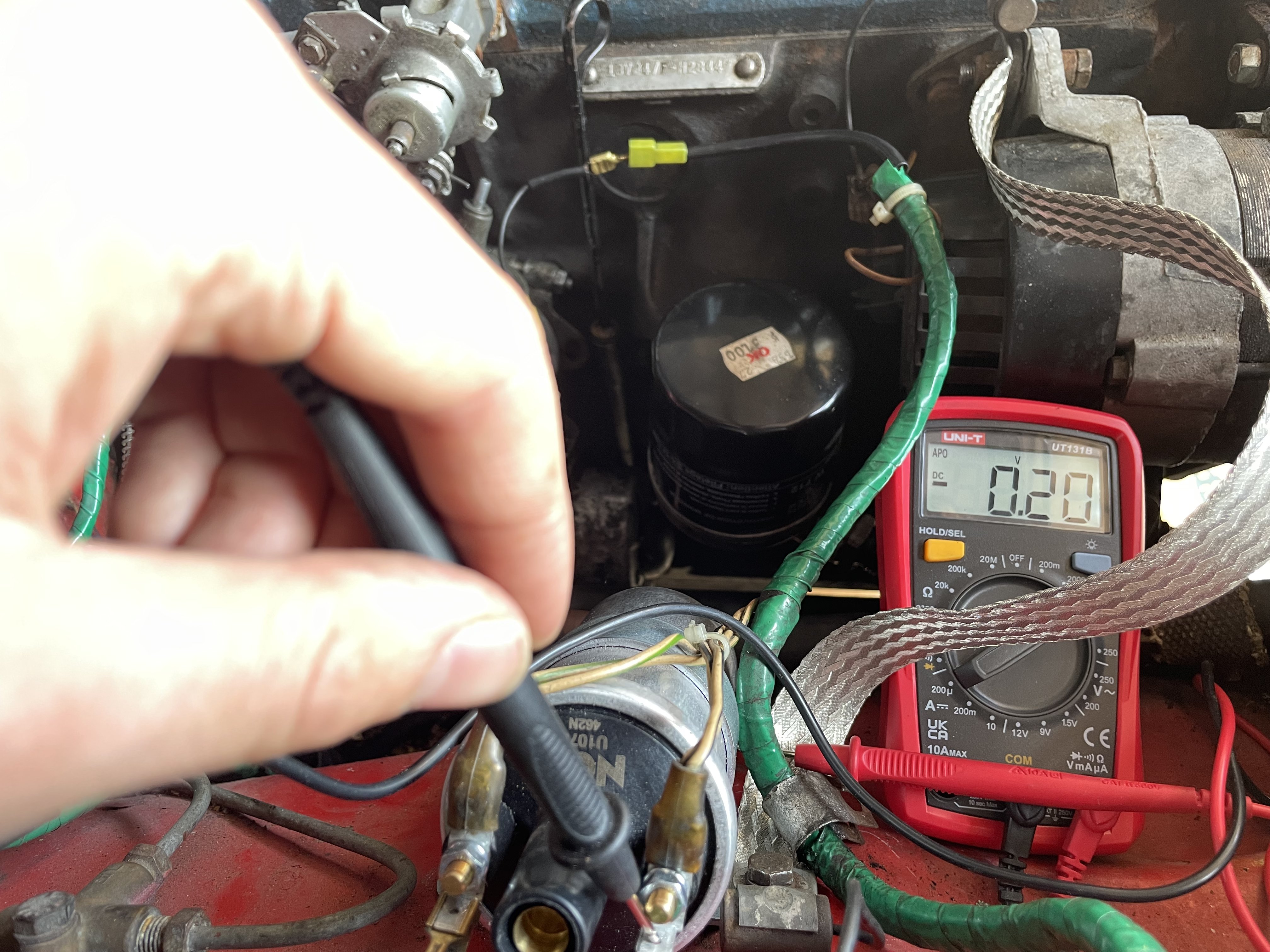

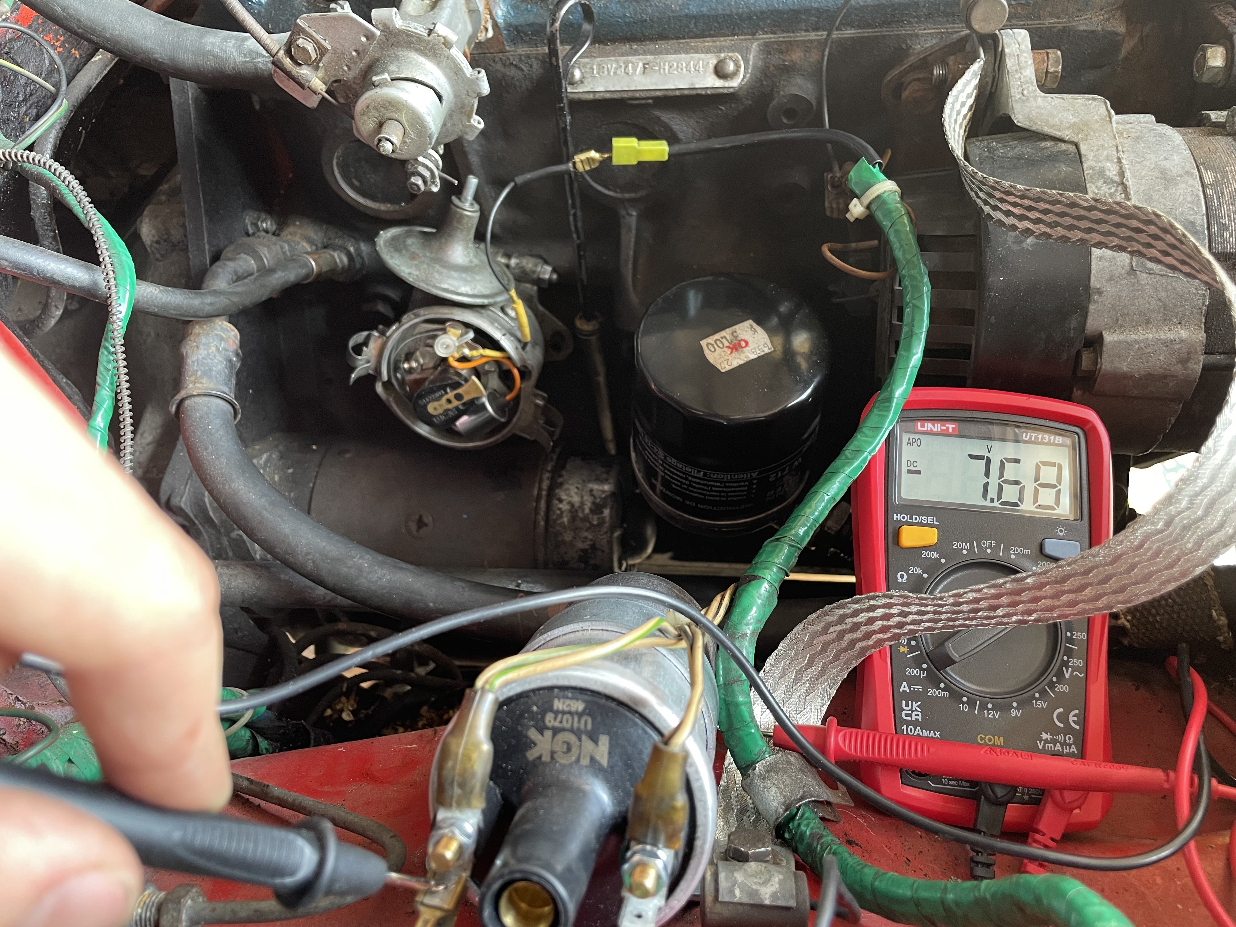

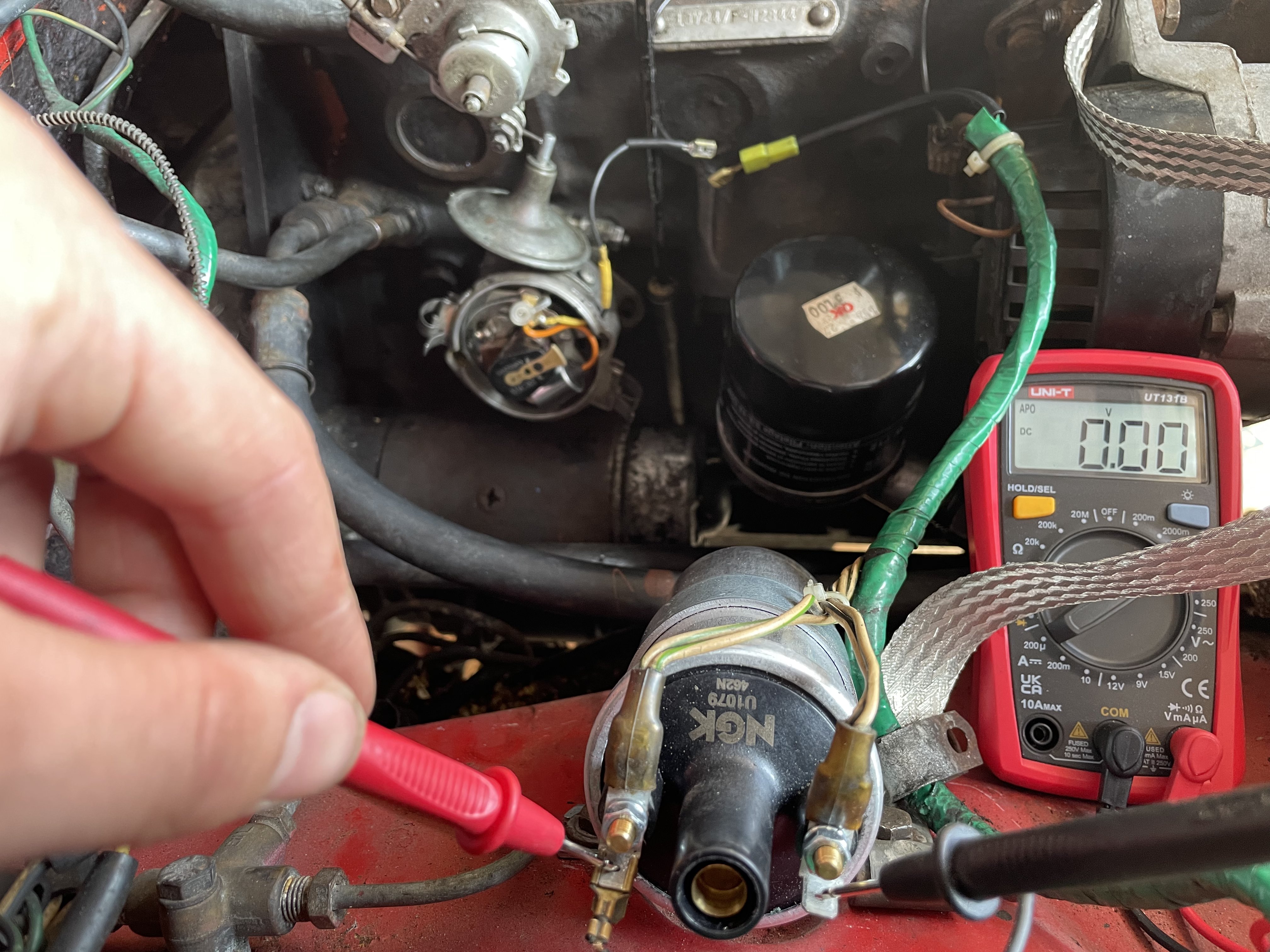

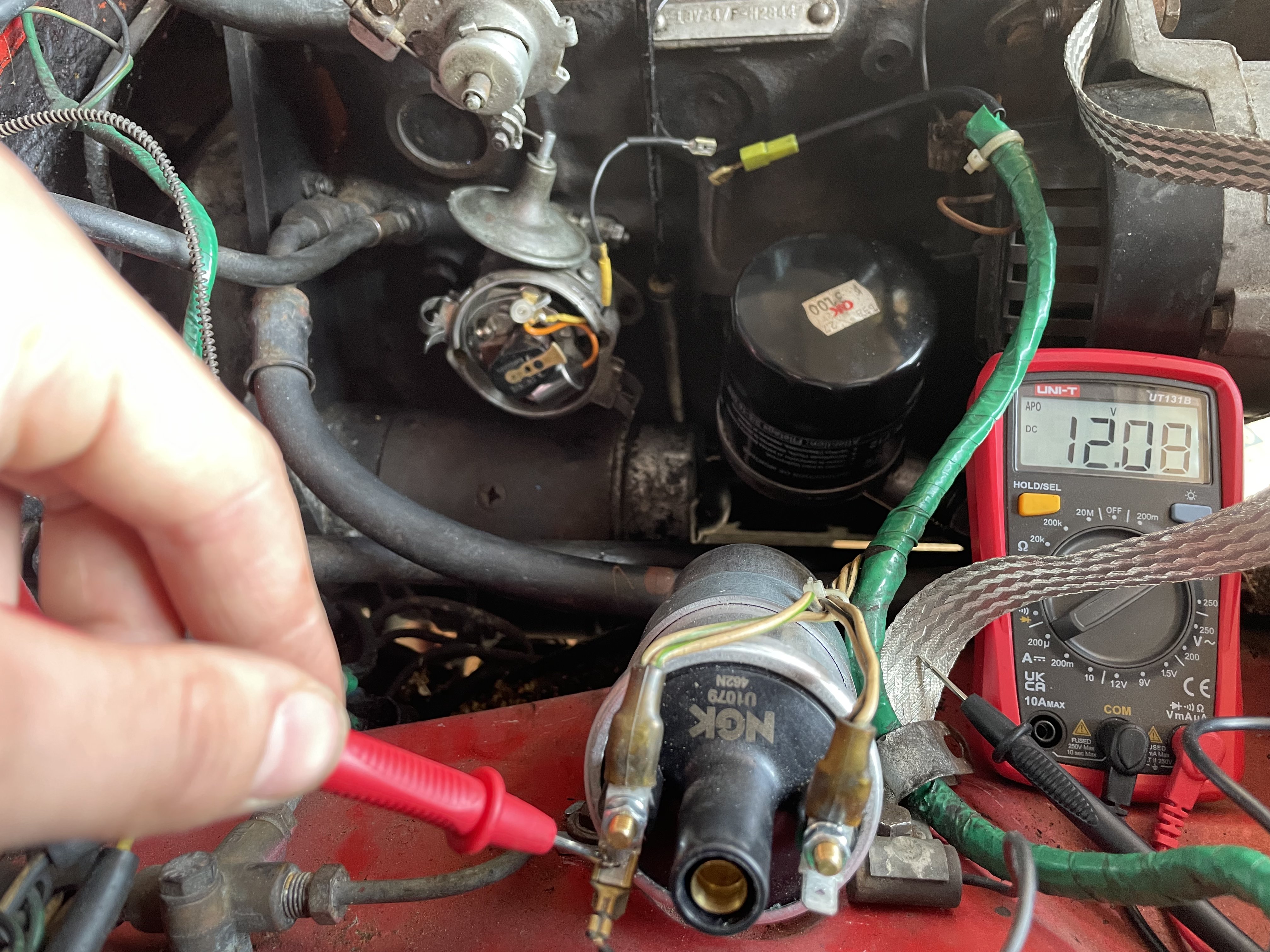

I have now the strap between the body and the engine, the previous one was bad. The engine is now cranking at a good speed, unfortunately, I still have no spark. I have switched out the rotor, the cap, all leads, and all spark plugs. I am not sure if the problem is in the low-tension circuit or the high. I have removed the lead between the coil and distributor and tested it for spark against earth while cranking the engine, this gets me no spark. Because of this, I tried to see if the coil got enough juice.
With the ignition on and with the low circuit cable between the distributor and coil disconnected I get a reading of 12 volts between both CB(+) and earth and between SW(-) and earth. Between CB and SW I get a reading of 0 volts. If I connect the low tension circuit I get a reading of 7,5 volts between CB and earth and between CB and SW. Between SW and earth, I get a reading of 0,2 volts.
While getting these results I got small blue sparks between the connections that connect the coil and the distributor (with the ignition on). Losing 5 volts through the low-tension circuit sounds a lot to me but I don't know. Could there be some sort of short circuit in the distributor?
I have attached some pictures that show my reading if there is any help.
Thanks for all your help, it is very much appreciated.

But if you have power to the coil then there has to be an issue inside the dizzy,
do you still have ouint or electronic ignition,
if you have points, turn the engine by hand with ignition off, make sure the point fully close and open,
with the points closed, turn the ignition on, flick the points open and closed and see if the HT lead from the coil produces a spark,
You should get very little or no spark at the points doing this. but the HT lead should spark.
if no spark then disconect the wire going to the points and flash it to earth, if still no spark from the coil, try a new coil.
If you now have a spark, fit net points and condenser.

Here are the pictures in jpg format :) I will check on the distributor tomorrow.
Thank you all for the advice

Hi, sorry for not responding sooner, I have had a lot of schoolwork this past week. Today I finally solved my problem and the car has spark! It turns out I had installed the pins wrong, so the low-tension cable was shorted to ground. Thank you all for the help and advice!
