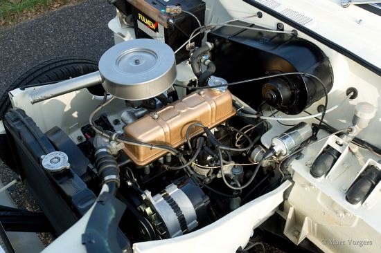

Doing some resto work on my '63 Herald, what is the correct original color for the engine block, valve cover and the generator? Some banana-brain tried to spry-paint these baby blue. In the car. Yerf.
Thanks,
Paul

It's actually a semi-flat black, not shiny but not flat if that makes any sense. The valve cover is a copper/gold color, I have no idea where you could find an original valve cover to match. Possibly someone out there could post a picture of an original? Hope this helps, got the information from a gent in Australia. PJ
PAUL161
Triumph Herald engine with valve cover color. PJ
Popeye
Bronze
