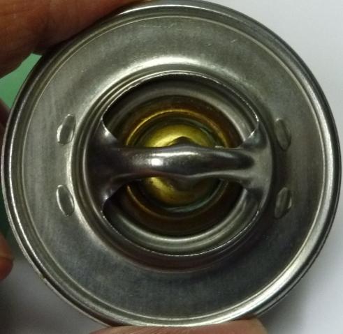

I run a 160 thermostat in SoCal - therefore I assume it's open all the time once the car's warmed up.
The OD on the raised lip around the center opening is 1-1/4", the ID of the hoses. Therefore it looks to be about 15-20% occluded at full open. Assuming the valve opens far enough that the lip and crossbar are the flow-limiting factor.
Will followup when I get my bypass sleeve with t-stat installed.
