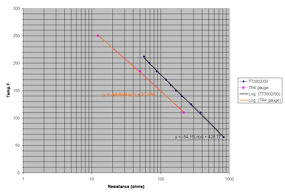

<div class="ubbcode-block"><div class="ubbcode-header">Quote:]Another question: Does anyone know what actual value temp. sensor resistance is at different coolant temperatures. I used my Simpson voltmeter but do not trust the readings yet.
[/QUOTE]
Is the 4A sender the same as the early TR4? For the early TR4, I have 110F = 216 ohms; 185F = 50.5 ohms; 250F = 12.3 ohms.

I believe the sender resistance is logarithmic through the entire scale. Those numbers were actually taken from a TR4 gauge (to confirm that the sender I had was the wrong one). But since that gauge seems to work very well with a proper TR4 sender (sourced from TRF), I believe the numbers are at least pretty close.
