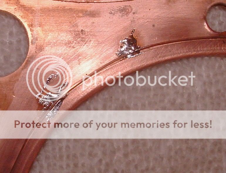

Yeah, I tried a lot of things, including new gaskets, various kinds of dressing and so on. Finally figured out that while the liner protrusion was fine on the side I checked, the liner tops weren't actually square to the block surface, and the other side was too low. I've found that on two engines in a row (now that I know to check for it), so I'm thinking it must not be all that uncommon.
The right solution of course is to have the block machined shorter on one side; but I was in a hurry to get the car back on the road, so I tried a band-aid fix. Worked so well that I never did get around to having the block machined.
The band-aid is just a ring of .016" (26 AWG) bare copper wire, tacked in place around each cylinder opening on the stock type composite head gasket.
DSCF0014_croplight.jpg~original
IMO, you would have better luck with a stock head gasket. The solid copper ones are tough to keep sealed for long, and better suited for racing where the engine gets torn down every few seasons anyway.
