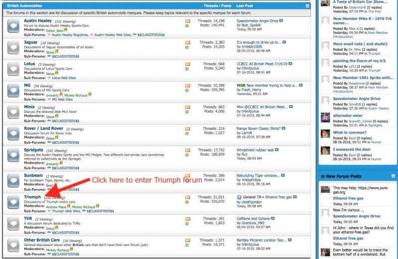

Mike, welcome to the BCF (and thanks very much for becoming a supporting member - much appreciated). Since you are asking a TR specific question, I'm going to move this post to the Triumph forum. The forum you posted in was the "Forum Software/Instructions" forum which is where you would ask questions about how to navigate the forum. For specific questions about your TR, you will want to go into the "Triumph" forum and post a new topic there. If you are reading this now, you are now in the Triumph Forum. I will leave a marker in the original forum you posted in that will re-direct people to this thread, which is now in the Triump forum.
