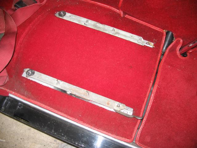

apbos
My seats are out and I will be heading out to see them in a few. Give me 2 hrs and I will let you know.
Paul
apbos
Bottom of seat:
For more pics see my flickr pages at Flickr and use the zoom function. Measured from the transmission cover nut on the floor pan at the front of the seat rails.
Paul
