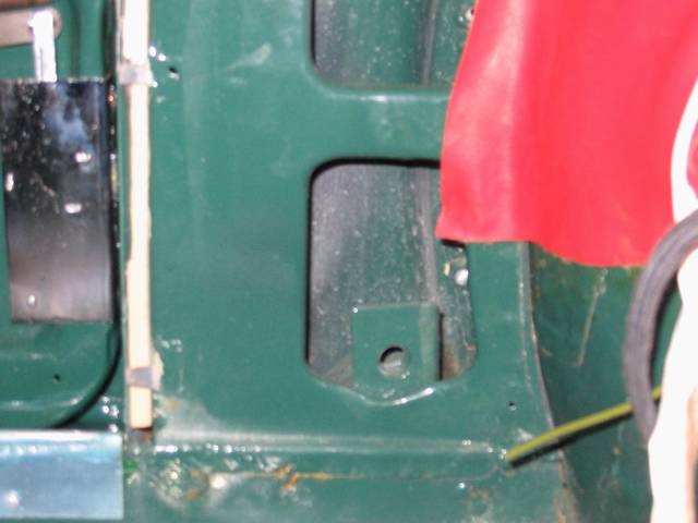

I welded it some angle pieces behind the interior rear dog-leg panel. In fact, it`s welded to the inner sill. For the center points, I welded in a curved plate under the drive-shaft tunnel. In all 4 points, I pre-welded huge nuts to anchor the bolts holding the flate plates at the ends of the belt buckles.
I did this on my black TR3A in 1989 and again a few years ago on the greeen TR3A I restored.

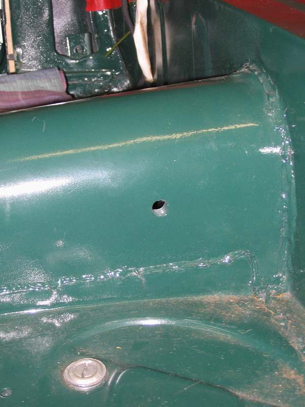

Here is the photo of the bolt hole for attaching the center lap belt in the driveshaft tunnel. In the distance you can see, once more, the bolt for the outer lap belt behind the "B" post.
