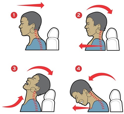

None of the belts will provide protection from whiplash when hit from the rear. In a Healey, the very low seatback will allow some force to be transferred to spine in the upper back. A higher seatback with no head support will keep all the force in the neck.

When I think of 'whiplash', I think only in terms of being rear-ended, and the type of belt doesn't appear to make any difference (again, IMHO). Doug
Keoke
YEP:
That is where you most likely to get hit.:angel2:
Thanks BOB"
