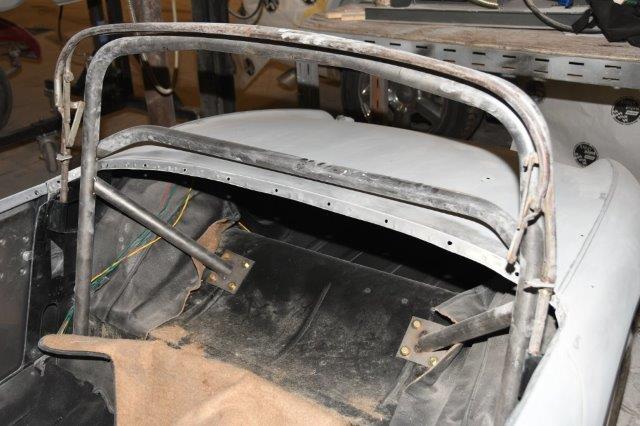

I've mentioned trying to develop a 'roll bar' for our bugeye (not for protection against rollover, but against pickup trucks running red lights) and here is where we are at the moment. The intention is to have:
- something that will fit under the 'hood', so it follows the outlines of the hood support
- the horizontal bar is to provide additional lateral strength for the mythical pick-up truck
- it also provides an anchor point for four point seat belts, which was my original plan but my concern is that other drivers might consider them too finicky and just go with a lap belt, so we're going to go with three point belts initially
- we'll be using the later split hood supports, as the original BE won't fit with the roll bar in place
Dunno when we're going to get the car finished up and on the road (the 84 year old chap building the engine has been at it for two years...!!!, but the body isn't ready just yet) but when the body/rollbar etc. is complete and we've had a chance to drive it (hopefully the existing engine will be capable), then I'll ask the shop to build another one for our Yellow Bugeye, and to document what it would cost to bend/cut/trim all the metal pieces but not weld them, and we'll see if anyone else wants one.
Rut - if you're interested, phone me 403 890-7143 cell and I can give you additional pictures. And I could also provide somewhat imprecise measurements if you wanted to try dummying one up yourself, and save you some of the development costs that have gone into this. Our first fitting was based on bending/cutting/tack welding a prototype out of electrical conduit, and you may want to consider the same. Doug
