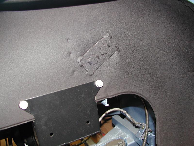

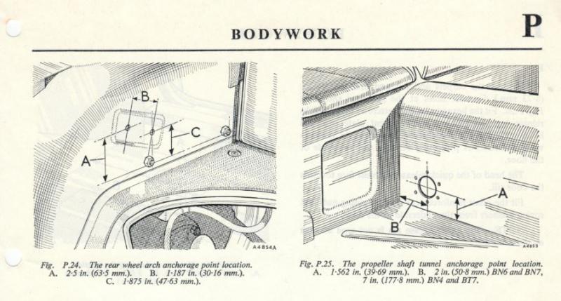

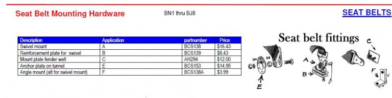

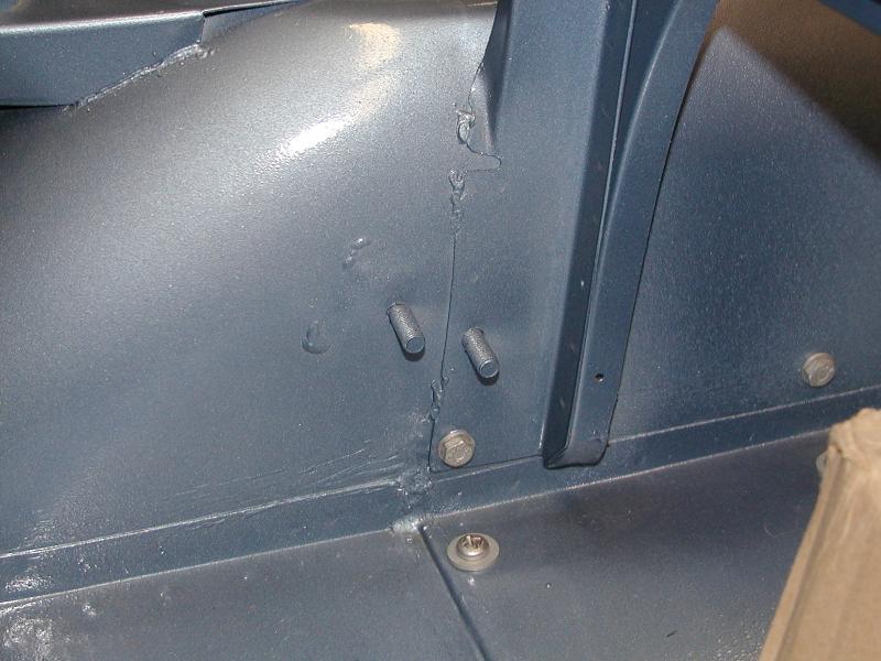

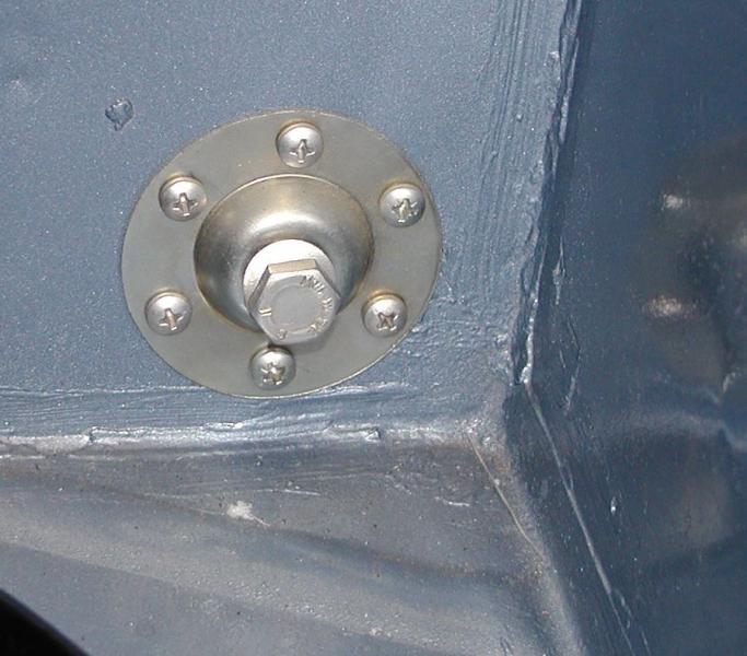

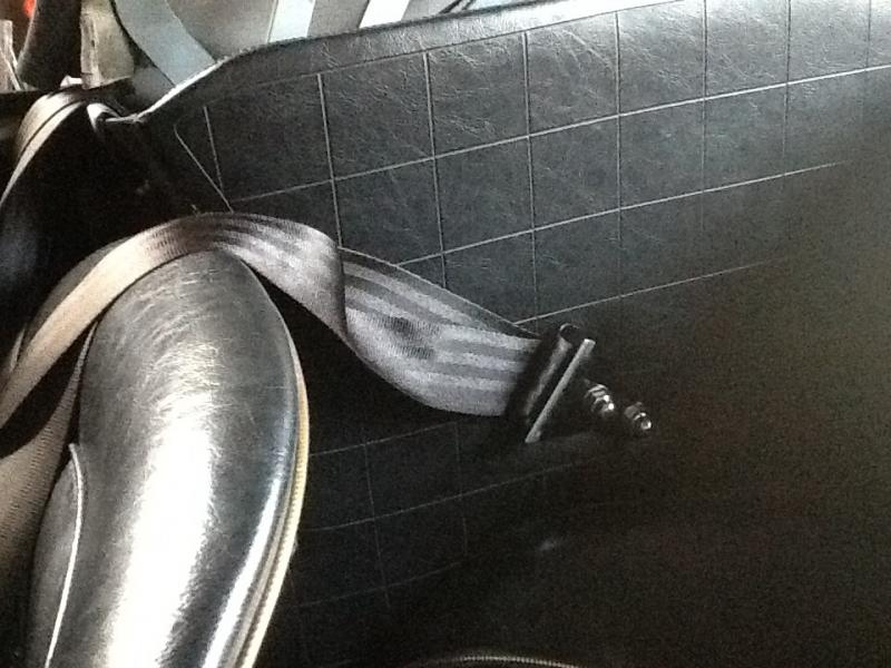

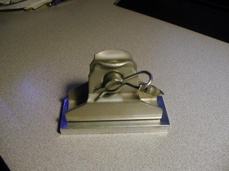

[FONT=helvetica, arial, sans-serif]My MKII finally has a pair of NOS 3-point seat belts - Britax, with the same part number listed on the AH parts manual. They came in original BMC boxes with fitting kits. [/FONT]61 was the first year for pre-drilled with reinforcement from factory, so it was pretty easy to install. Only had to crawl under the car for the tunnel bolts, with my 11 yr old daughter holding the wrench up top.
I've never seen them installed on another Healey before and I'm curious if there are others that have them. I've seen a lot of the lap belts that are offered by folks like Moss, but never a 3-point. I've only been to one concours event, so my population is somewhat minimal. I[FONT=helvetica, arial, sans-serif] posted on the AH Facebook page and didn't get any other pictures. Please post some examples of them if you do.
