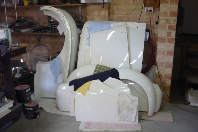

Graham H
I did much the same with the large pieces and most of the smaller items were powder coated or anodized

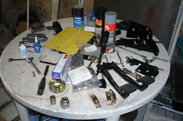

M_Pied_Lourd
Can’t you just lay them out on the dining room table Frank?:p

Frank Canale
LOL !!! Dining room table full of parts in progress. Going to have to get a table that seats 12. Frank
