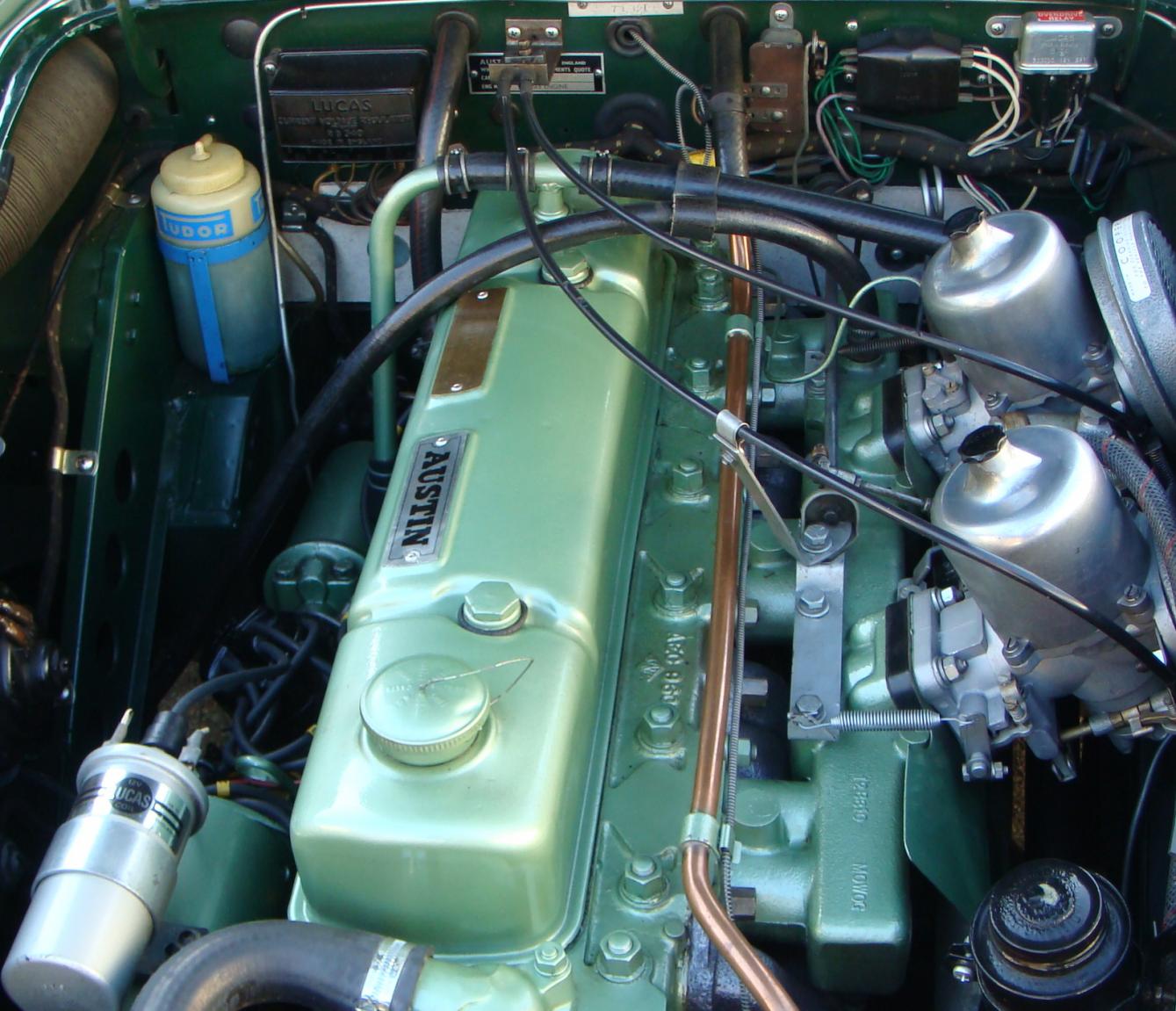

After you thoroughly clean the aluminum intake, wipe it down with lacquer thinner or xylol and a clean cotton rag (old white t-shirt). After the solvent has completely flashed off, blow the surface off with compressed air to remove any residual lint. Next, apply 1 light coat of self-etching primer. I like this one the best, its light green color works very well under the Healey metallic green engine paint. https://www.summitracing.com/parts/smm-39693?seid=srese1&gclid=COLQyfO5-7kCFeU9Qgod4AcAjg Let air dry 1 hour at 70 degrees, then apply 2-3 light even coats of metallic finish.
There's the motor I did on my '65 BJ8 15 years ago.
