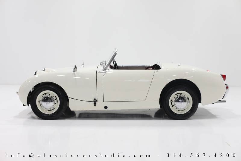

Has anyone seen firsthand (or own) a car with wheels that are painted in another color other than silver? A search on Forum did not yield results but I may have done it wrong. My Sprite is freshly painted in a version of OEW and I'm considering painting the wheels in same. She does not have wire wheels or whitewall tires. Same wheel as shown in attachment. Wondering how the paint holds up to road conditions. Is there a particular paint or process that is recommended?
Going for his look...

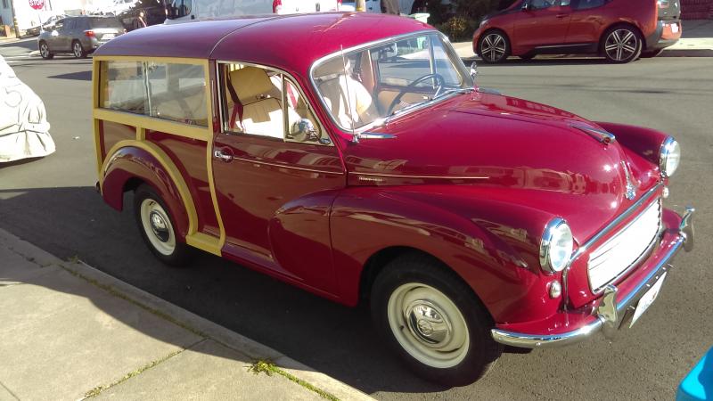

Powder coat is also an option. It's more durable and with the amount involved to prep each wheel, you might find it's worth the money to have them sand blasted and powder coated. I recently did a set of 5 Morris Minor wheels in OEW, and they were even brand new wheels. I don't recall exactly, but I don't think cost was more than $50 each.

Thanks for the input, Gerald. Such a cool looking vehicle! OK, I'll look into powder coating. Price is certainly reasonable.

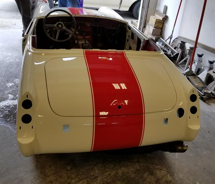

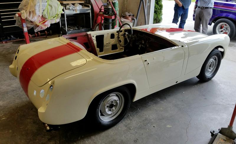

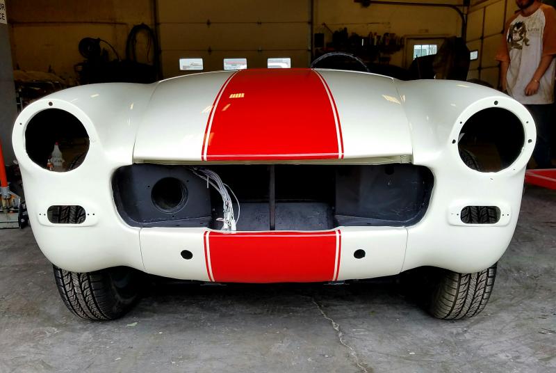

Brought home baby yesterday!
This was meant to be a winter project so we could be driving now. Ahh well, she'll be ready for beautiful fall drives in the Bluegrass.
PS. In case it was misleading, the lovely white Healey pictured in my earliest post is just an example of painted wheels, it's not my car.

Honestly you could paint those wheels sky blue pink with a finiaty border and it would look amazing!
SaxMan
Nice! Looking at the car, I don't think white wheels would complement the look. I'd either stick with the silver, or, call me crazy, but painting the wheels the same color red as the racing stripe would give the car more of a "race car" look and help complement the red stripe.
Jim_Gruber
And trim rings really look sharp as well. Not sure though if they would work with those rims but I think so.
glemon
I agree with Saxman, I am not too big on wheels painted the same color as the car, but if you did do something besides traditional silver I would go with the contrasting stripe color too.

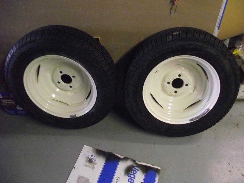

I have gone both routes, powder coat and paint. Wheels hold up better than about any other item on a car. They don't seem to take direct hits like other parts.
This is the paint on my Bugeye.
They were blasted and then I primed them with an acid etch. Then baked them in my homemade oven.
The only way to really paint them is to have the tires removed. I have sanded and painted and they had a nice finish as well.
I have bought the red paint and a pin stripping brush once I have them on a spindle to rotate.
Jim_Gruber
Can you say "Necessity Is..." Now if I hadn't thrown out that old Weber two weeks ago. This does me ideas for powder coating other than using the spare oven in the basement and the resulting smells that would permanently reside in my house.
