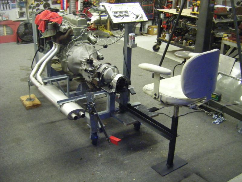

If you have the space, set up something like the photo, to run the engine in, and also test the gearbox. Nice to hear it as you get the rest of it done - the sound might be motivation to get it done.
