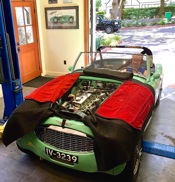

I just broke-in my new race motor a couple weeks back. This is about the 5-6 one over the past 15 years, I always run them in with Joe Gibbs
https://www.drivenracingoil.com/dro/br-break-in-oil-16060html/ I have an accusump, so I can prime/pressurize the system prior to turning it over. Once started, I run it at 2500 rpm for about 30 minutes while I check the the temp and oil pressure and adjust timing. I also have an additional fan running towards the front of the car. And good assistant is usually great ideal.

Doug,
I especially like the look on your "good assistance" face.... I've seen that look many times on my lovely assistance's face as she's been summoned to the garage to help.
dougie
Doug,
You nailed it Steve, I'm lucky she's a good sport.
HealeyPassion
Steve, I hope you don't refer to them as "dreaded assistants" while they are within hearing distance.... or the cost will go up dramatically!!
